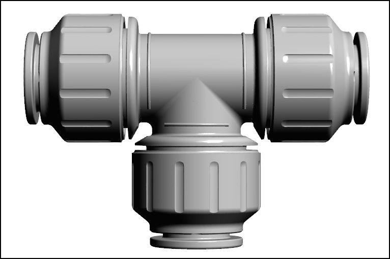

just got the 105xf and cannot find which fitting i need for air duster. the outlet valve is under drivers seat…daf want £40 for the kit i just want the valve male coupling,
any POSITIVE links would be gratefully appreciated.
please no conjecture as in (i think/maybe/try this" cos if it dont fit i have wasted about £20)
cheers guys/gals
i bought the black air duster with a sort of T bar fitting that came with it.
our fitter just cut the pipe under seat put either end of the pipe in the T bar and it works a treat.
hope this helps.

cheers bud, ours at the mo are rental so may be iffy to do that

if you remove the already fitted coupling between the air supply and the seat, just fit the T piece that comes with the black air duster, no need to cut the pipe

You only want one of these. It will cost you pennies
