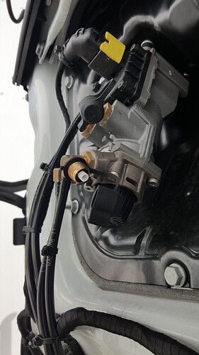

To make you aware I bought AllRide heavy duty air duster for trucks max. pressure 13 kg/cm2 from the truckstop and I am looking to fit this:
onto that one:
I cannot do it as it is a little bit too small and I am asking for the size to fit. Pirtek did not help.

There’s no need to connect your air duster to the pipes under the grill. That’s a very awkward way of doing things plus I wouldn’t want to mess about with them as they could have something to do with the foot brake valve!!! That’s why there’s a proper connection behind the driver’s seat.
Get the series 21 fitting!!!
