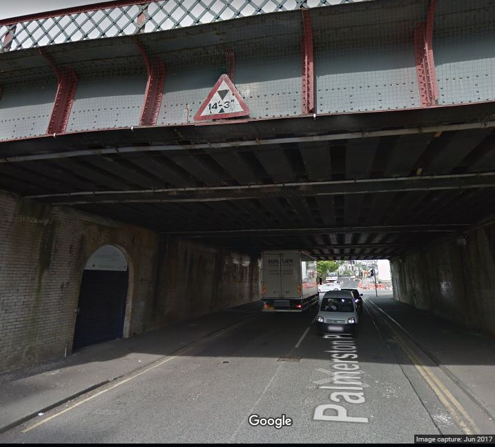

I know how stupid lorry drivers can be, I am one. However, I don’t think that their confusing signage helps.This is a bridge that was struck this week
This bridge is also on the most struck list
So in the Midlands 4.2m equates to 14 feet but in Dover 4.2m is 13’9.
I phoned Network Rail to inform them and they said the that they aren’t responsible for the bridge height markers. It’s down to the relevant Highways Authority but surely if this is causing such a big problem then maybe they should look to auditing the bridge height signage.
The difference is probably because neither bridge is exactly 4.2 meters high, and the next value in metric would be 4.3 or 4.1 meters. Those 10 centimeters (either up or down) equate to 4 inches.
Bridgeheight signs come in 3 inch graduations, so if the clearance is just under 10centimeters but more than 7.5 centimetres, you drop (or raise) a 3 inch gap. Contrary to popular belief, one measurement is not simply converted from te other, but both are as close to the actual clearance of the bridge.
That is not to say that the relevant authorities can get either measurements, or order forms right…

john_london:
It’s been done to death many, many times - the calculation used to arrive at the marked clearance height for a bridge is different for metric and Imperial measurements:
A bridge measured at anything from 4.28m to 4.37m should be marked as 4.2m
A bridge measured at anything from 14’3" (4.34m) to 14’5" (4.39m) should be marked as 14’
A bridge measured at anything from 14’0" (4.27m) to 14’2" (4.32m) should be marked as 13’9"
So the first example could have been measured at 14’4" and the second one at 14’1" - both would be correctly marked as 4.2m
