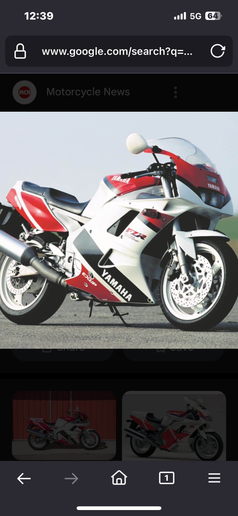

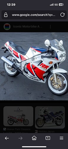

Doze, these three I wish I had bought years ago, maybe it’s too late?
The Suzuki RD 500, nicknamed the rocket ship and the FZR 750 and the FZR 1000 Genesis range.
