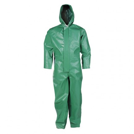

hydrochloric is nasty stuff… personaly i would wear everything given not only have you got the dangers of the acid its self you are mixing an acid with an alcaline.
i used to deliver 90% in 5 gallon containers they always wore apron and gloves to take it off the back of the lorry and that was in sealed containers just being taken into thier stores.
dont forget its splashing around and your pouring it in so you are bound to get some on your clothes
