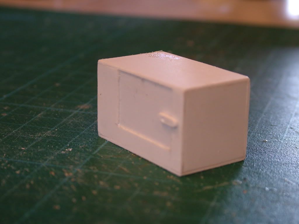

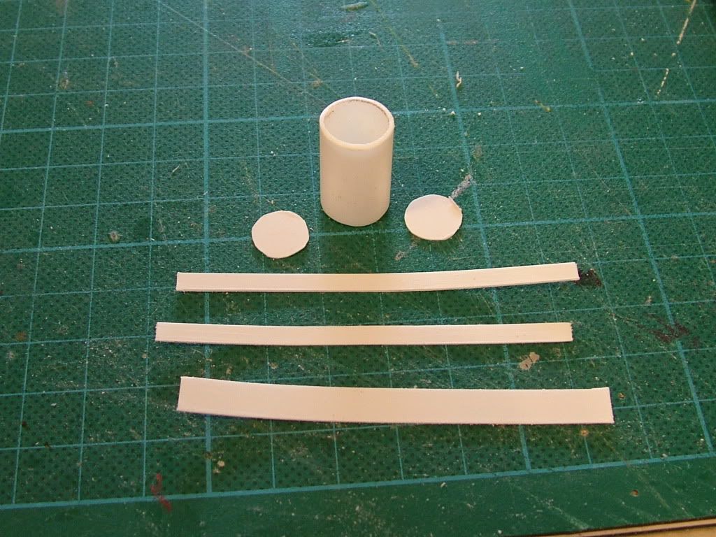

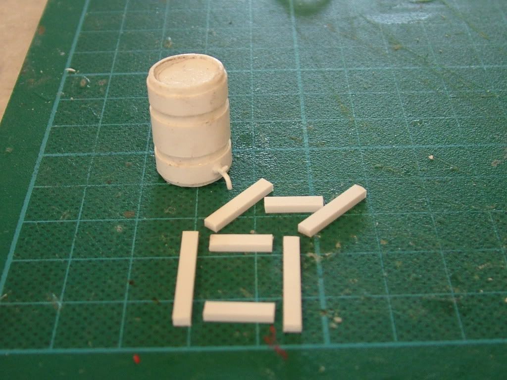

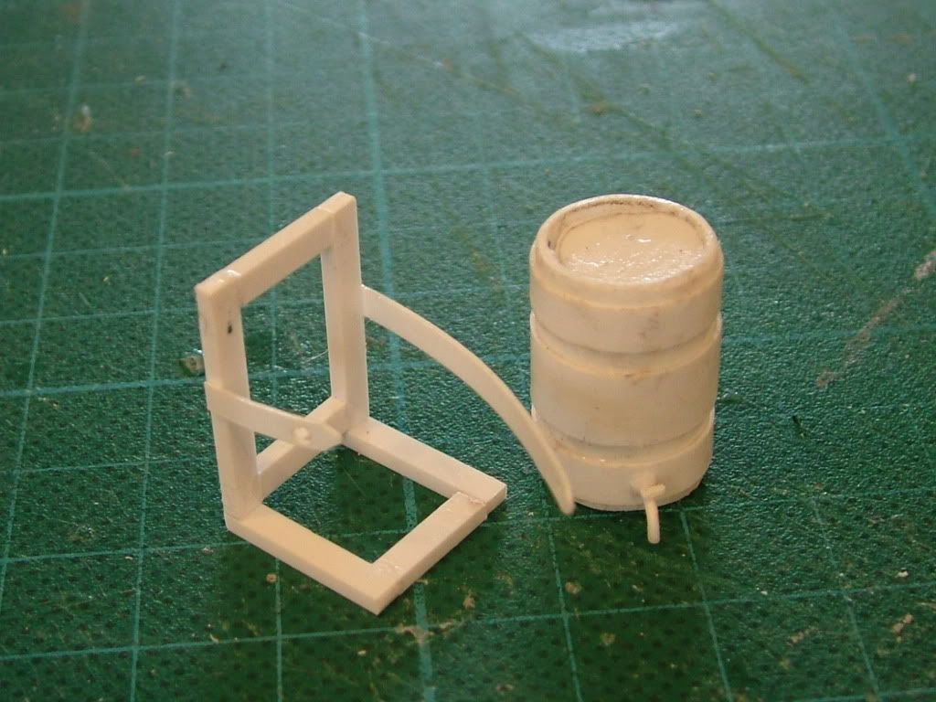

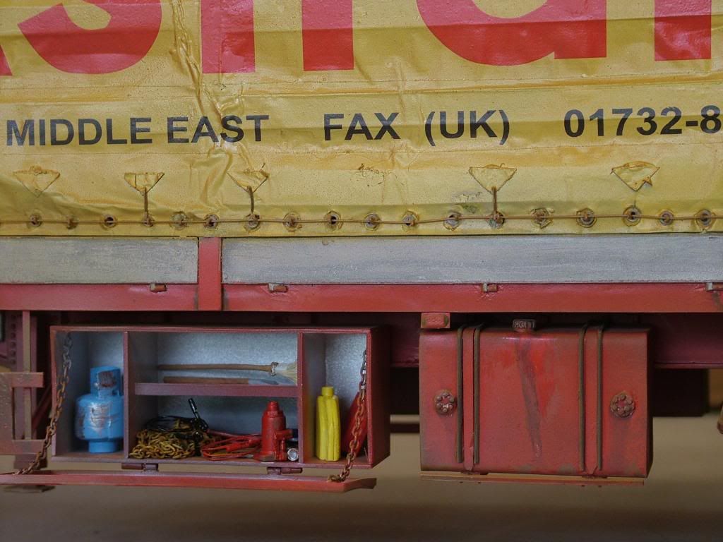

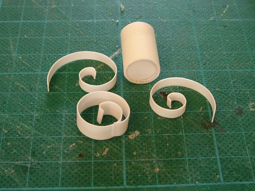

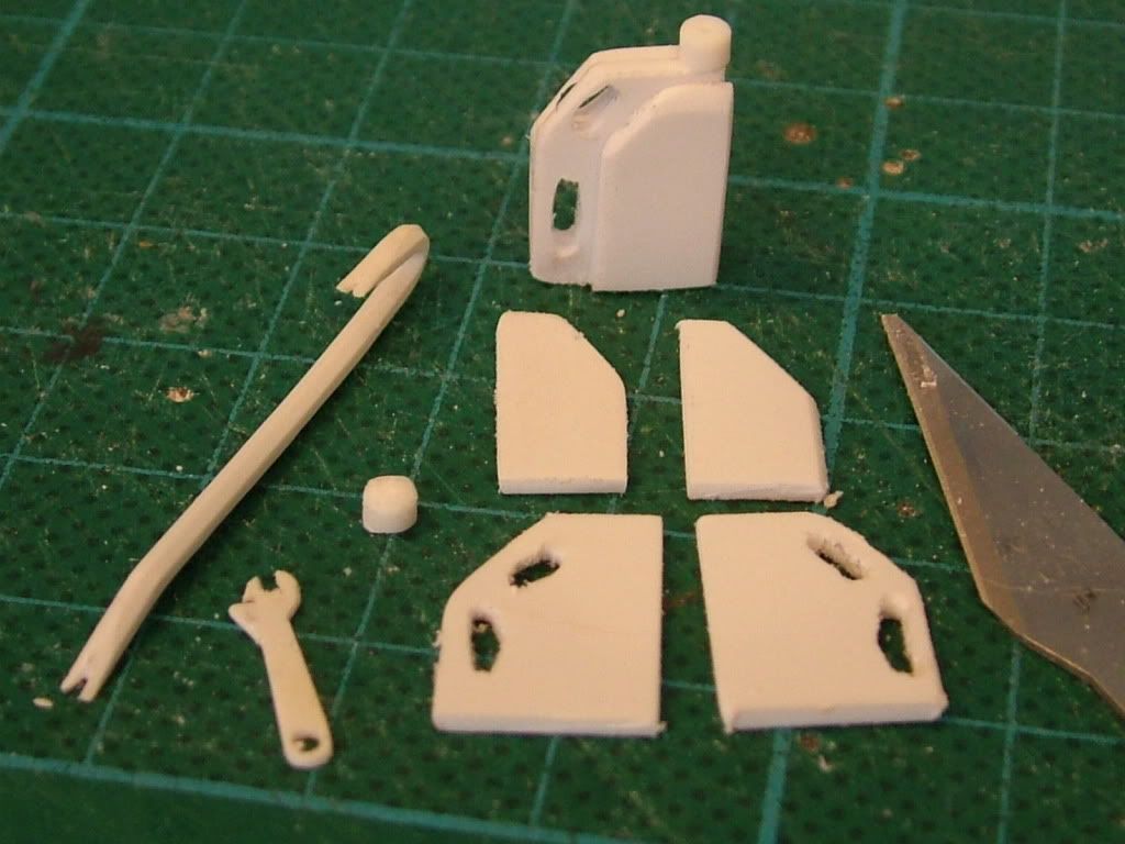

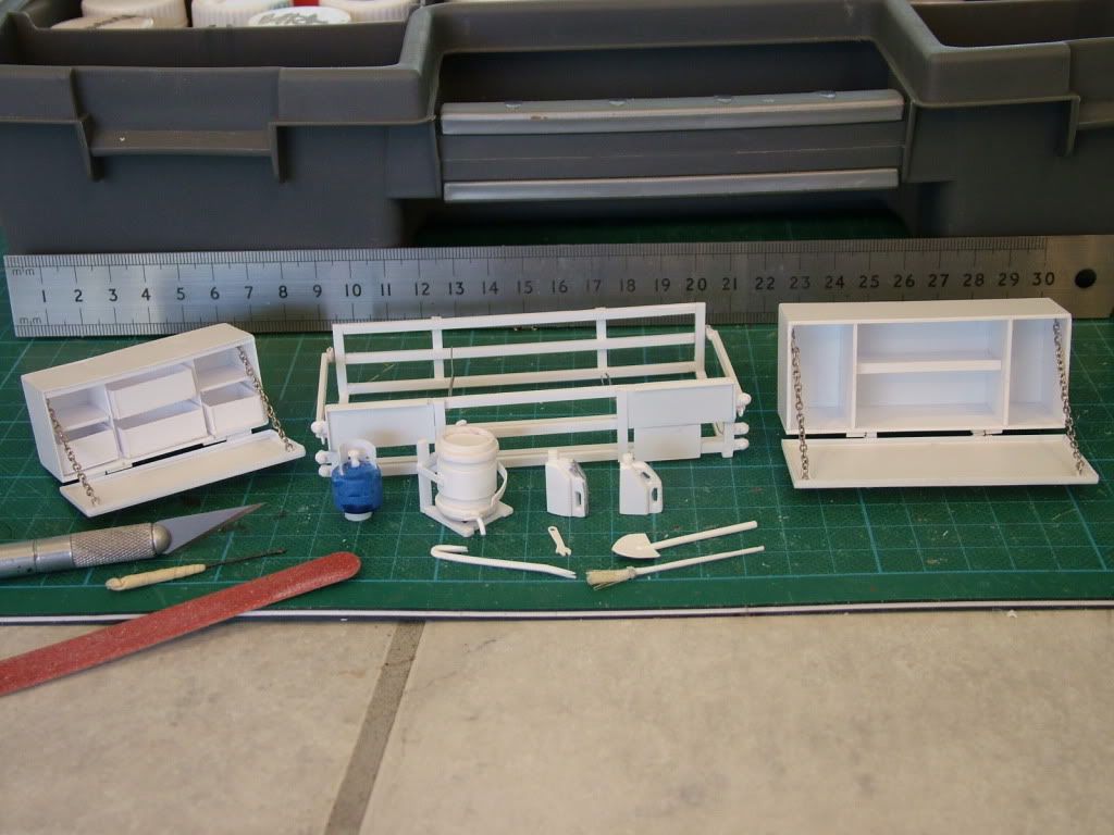

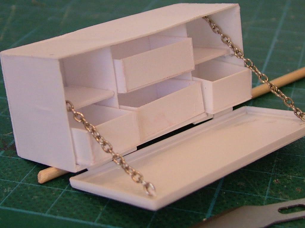

Here you go NNM some basic boxes with a bit of dressing up…
Sauid spec cool box
when you get a bit more advanced…
And when you have to much time to spend
Any questions just ask…
Jeff…
No questions, I’m impressed to the point of speechlessness.
Great work Jeff!
What the f**k?
I love the water container and the shifter spanner good stuff Jeff. Here’s a couple o photos of bits I made for a 1950s fire engine I am building. Eddie.

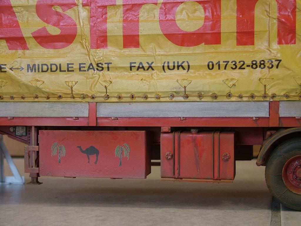

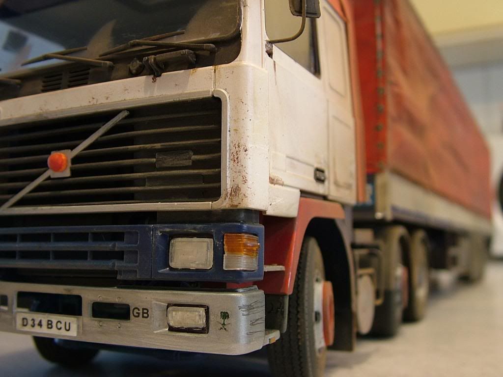

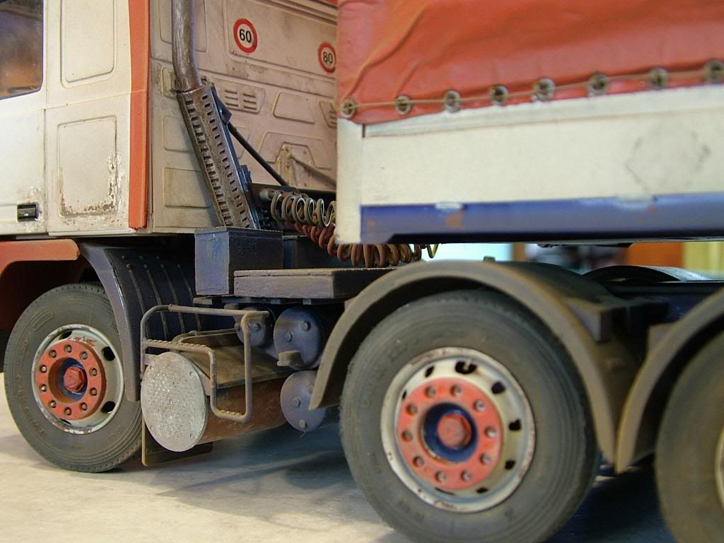

Here’s some rust effects for you ILAnd a rusty tool box door on an F series Volvo…
Jeff…
did you use a brush

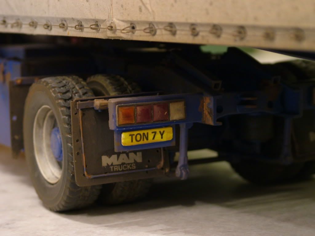

Good looking detail there Eddie, it’s a harder to do the show room floor stuff like you do than it is to weather them. If you get a blob of something in the wrong place or if something’s not quite square they it’s all over, and you have to do that bit again. If your doing weathering then you can make that into something or say it’s had a bit of knock, it just adds to the final look. That’s why most of my stuff is weathered
IL for the rusty toll box door I painted the cab white then a few days after that I blobbed a bit of Humbrol rust colour round where the seeme would be, let that dry for a day or so then go round the edge of the rust with a bit of white Humbrol to make it look like the whites peeling back over the rust. Other that the drying time the whole job took about 20 minutes. For the rust on the front of the cab, I think I used either a small paint brush or cocktail stick, probably both, and the paint was both straight from the tin and thinned out for different effects.
For the exhaust down pipe and can, I get a bit of baking paper ( grease proof paper ) to use as a pallet. Blob a bit of gray, white, black metallic silver and a couple of shades of brown on to it with some thinners and paint it all from end to end with the gray and silver colours. As it’s drying ( 20 to 40 minutes ) I stripe on more colour with a hard hair brush and that gives it a pitted rust look. Let that sit for a few hours or days, then get back into it with the shades of brown, you can either stripe that on or do light, very thinned washes until you get something that look like what you wanted.
It’s not that challenging but it is good fun, there must be 1000’s of utube vids about weathering, have a look and give it go.
