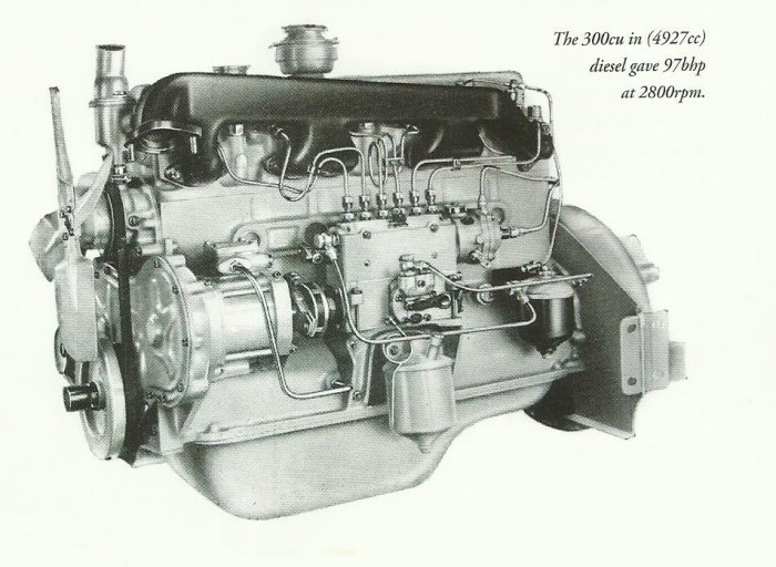

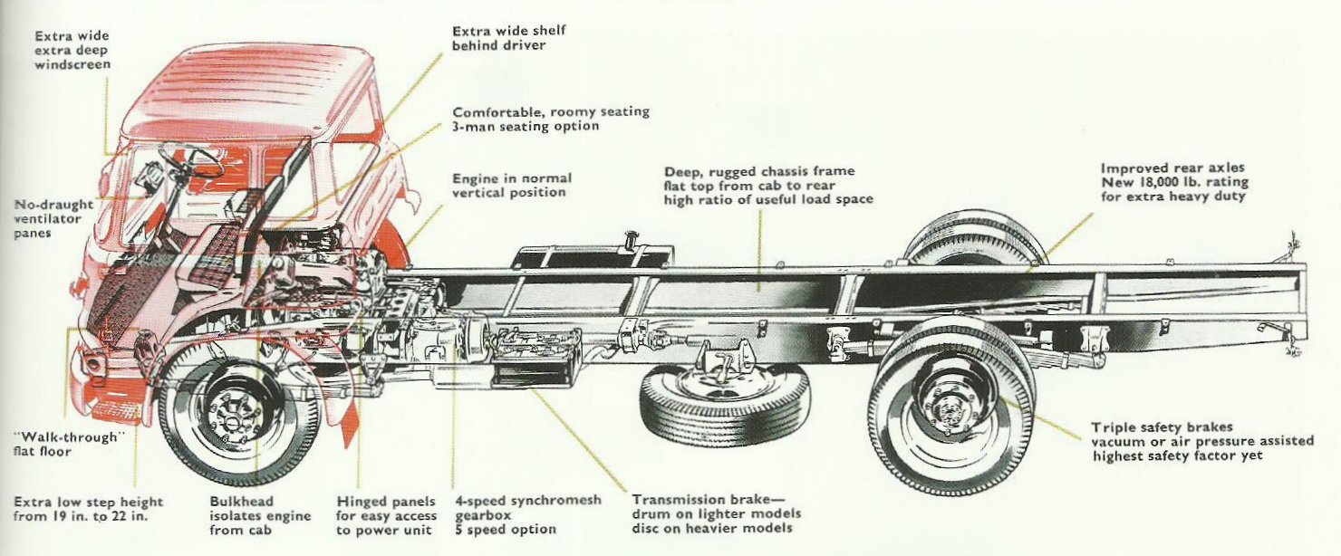

Here is a little information I have on the TK and Vixen engines, Franky.
Frankydobo:
2
Great Stuff Franky, That Bedford 300 was OK in a four wheeler, But I drove a TK Artic for Baxters on the Quayside with the Scammell Auto/Coupling, I used to run to Manchester/Liverpool/Chester loaded with 12/13 Ton of bacon, It was useless on the pull, bottom gear up Church Bank just to get off the Quay, They nearly scint old Jonny, But they did have a good heater in wich was a bonus in 1960, Happy days Eh, Regards Larry.

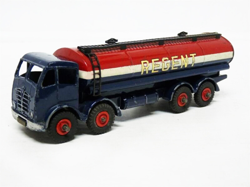

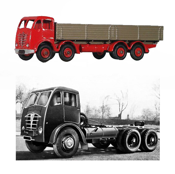

About Fodens, for instance: which version is the one here reproduced? When has been introduced?
I know this kind of trucks employed Gardner diesel engins. Is it true?

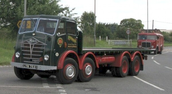

Larry Dunbar could give you the full spec on this Foden,but I believe it was classified as an FG,and yes Fodens were one of Gardner Engines long time customers right from the concept of Diesel engines,or “Oil Engines” as they origionally called.Foden did persist over many years with their own two stroke engine but it was never a success and eventually it died a death.Cheers Bewick.
Was’nt an FG a Gardner and FE a stroker?
pete smith:
Correct Pete and fitted with the S18 cab as well. Gardner would have been the 6LW in the eight legger.
I think your right Pete but I will have to defer to superior authority on the thread,the nearest I came to a Foden was photos of my Great Granddads Foden steamers of 100 years ago.Cheers Dennis.

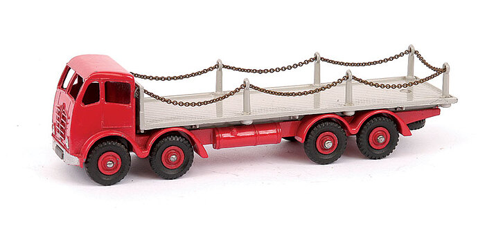

Foden 2 stroke and a Gardner
That was very kind of you, Franky.
As the Dinky is classified as a “4-ton lorry”, it must definitely be a Vixen!
Nevertheless, is it sure they all three (Wolf, Vixen and Otter) used the same 4 in line cyl?
I believe that a Meadows diesel engine was also an option in the smaller Guy vehicles? They were manufactured in Wolverhampton the same as Guy.
Pete.
I did not understand this point (be patient: I am a foreigner, both with English and the matter).
Anyway, I assume that Foden FG used a Foden 6 cyl diesel two stroke 4.090 cc 126 hp, while the
Foden FE had a Gardner diesel 6 cyl 112 hp. Am I right?
Now: which was the Gardner engine capacity (how many cc)?
When have been FE and FG Foden introduced, and when they have been ceased?
Was the S18 cabin common to both models?
How can I consider this Dinky: a postwar FE/FG?
Sorry to bother you, but you are my only reliable source…
My apologies, I forgot that you are not familiar with English vehicles. The Foden FG would have the Gardner engine, the FE was fitted with the two stroke. The S18 cab was introduced in 1947 so certainly after the War. They replaced the earlier DG range, Dinky Toys made models of those as well as you are probably aware. Foden made many different cabs and they produced several different cabs at the same time so that customers had a choice. The S18 cab was replaced by the S20 cab in 1956 (the Matchbox model sugar tanker, concrete mixer and the King Size breakdown truck has that cab) but some customers still wanted the S18 so Foden carried on making them as well! Very confusing the Foden cab range, a Google search will show you all the different types.
I am not sure of the C.C of the Gardner engine as I have lent my Gardner book to a friend, I am sure that somebody on here will know. I would guess at around the 11,000 cc area but I may be incorrect on that.
Hope that this helps you, any more questions just ask.
Pete.

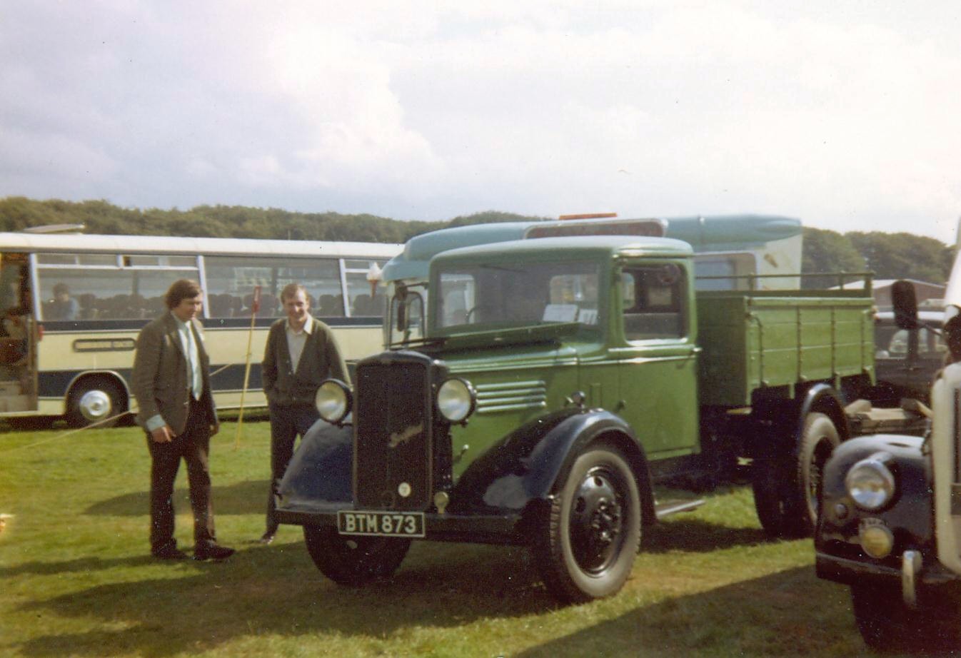

Re: this batch of your pictures – some corrections.
You are right about the Opperman Motorcart, the Bedford VAL coach and the Dodge Kew. But I believe that the brown Dinky breakdown lorry model like many early Dinkies wasn’t based on any particular real lorry, but a generalisation based on lorries of the day. The real green lorry in the photo you’ve attached to it is a Bedford WS, but that one has a cab that must have been locally built in the country where the photo was taken, the British cabs looked like this:
Thank you, Peter, with these news I can finally fullfill my Fodens documentation.
Just one thing to be sure: the Dinky Fodens are fitted with an S18 cabin, isn’it?
Yes that is an S18 cab.
Pete.
