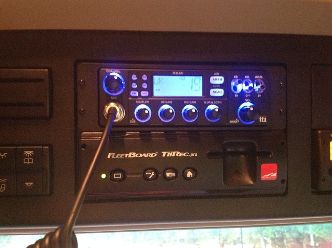

Like this brother rubber. :smiley:
the maoster:
just out of interest, how did you wire that up?? I got a 12/24 volt cb, but there seems to be nothing to plumb into. May do it Scaniason’s way…
kindle530:
the maoster:
It is indeed a 12/24v jobbie that I have too. It was wired at first into the Fleetboard thingy but was giving a wierd “pulsing” effect, so I just bribed one of our fitters to rewire it to the interior light switch just to the left of the CB, job sorted.
