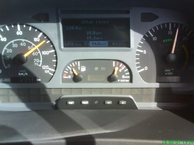

At this point I reckon I’ll add a pic of my display, just for clarification of course!
Thanks for the replies by the way…
Here’s the pic, the TRIP button resets the hours/MPG/miles counter only…not the KM’s
It seems logical to be able to reset the tripmeter at the (previous post) above screen, but no, you have to go up 2 screens to the one that displays your current speed and then press the “trip” button.
