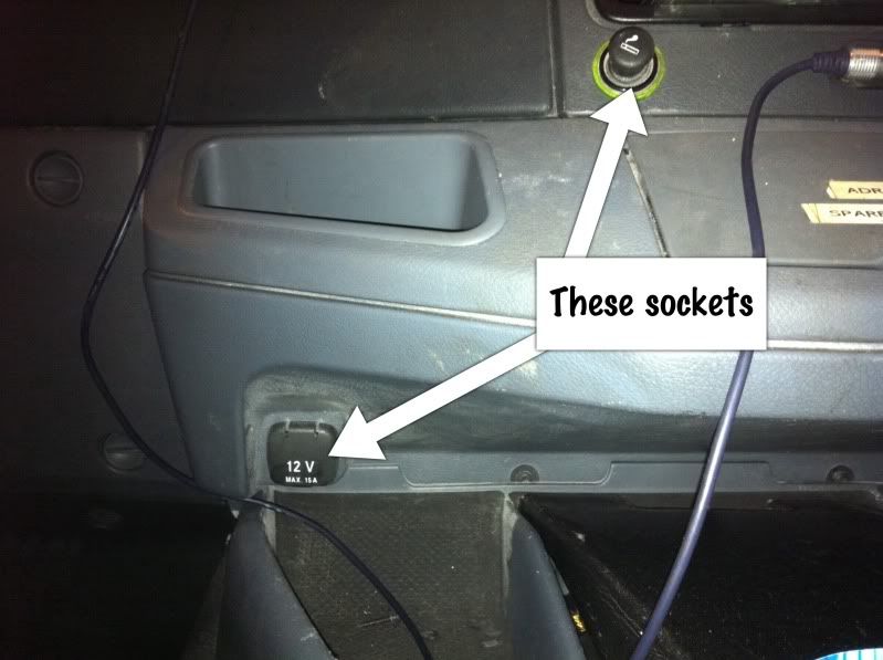

Gents, my truck (57 plate Axor) went in for a major accident repair a few months ago (night driver tw@tted it while I was on holiday) and the cab had to be totally stripped. All the work has been done, albeit to a poor standard imo and two of the power sockets don’t work anymore.
The cigar lighter and the 24/12 drop socket, both on the nearside (passenger). Thing is, I used the 24/12 one to power my laptop and I don’t know what’s wrong.
I’ve checked the fuses and seem to be ok.
The wiring connector is on both sockets so that looks ok too.
Any ideas? I just don’t know what else is could be!

Can you not see if they are plugged in from behind?

See I the fuses are connected? Can’t get behind it at the moment. I’ll try and have a look when I’m back at the yard on Monday night.

Don’t know about Axor but Actros power sockets are covered by other fuses as well. I assume they are Merc trips not fuses? Try resetting all of them taking notice of the ones at the sides of the fuse box in particular.
