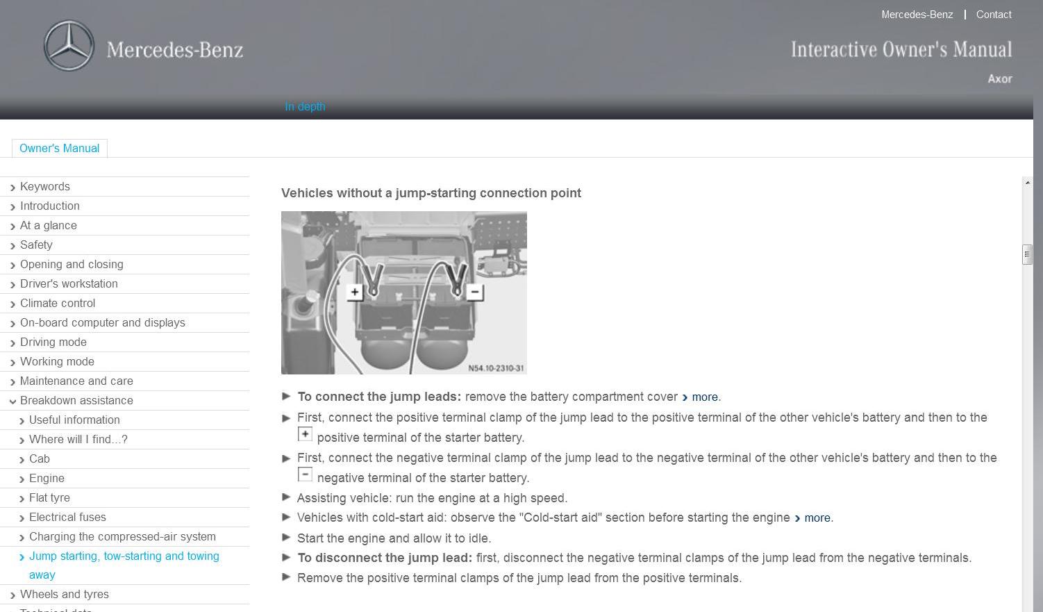

Click on picture to enlarge
Online Manual
www4.mercedes-benz.com/manual-tr … base.shtml
