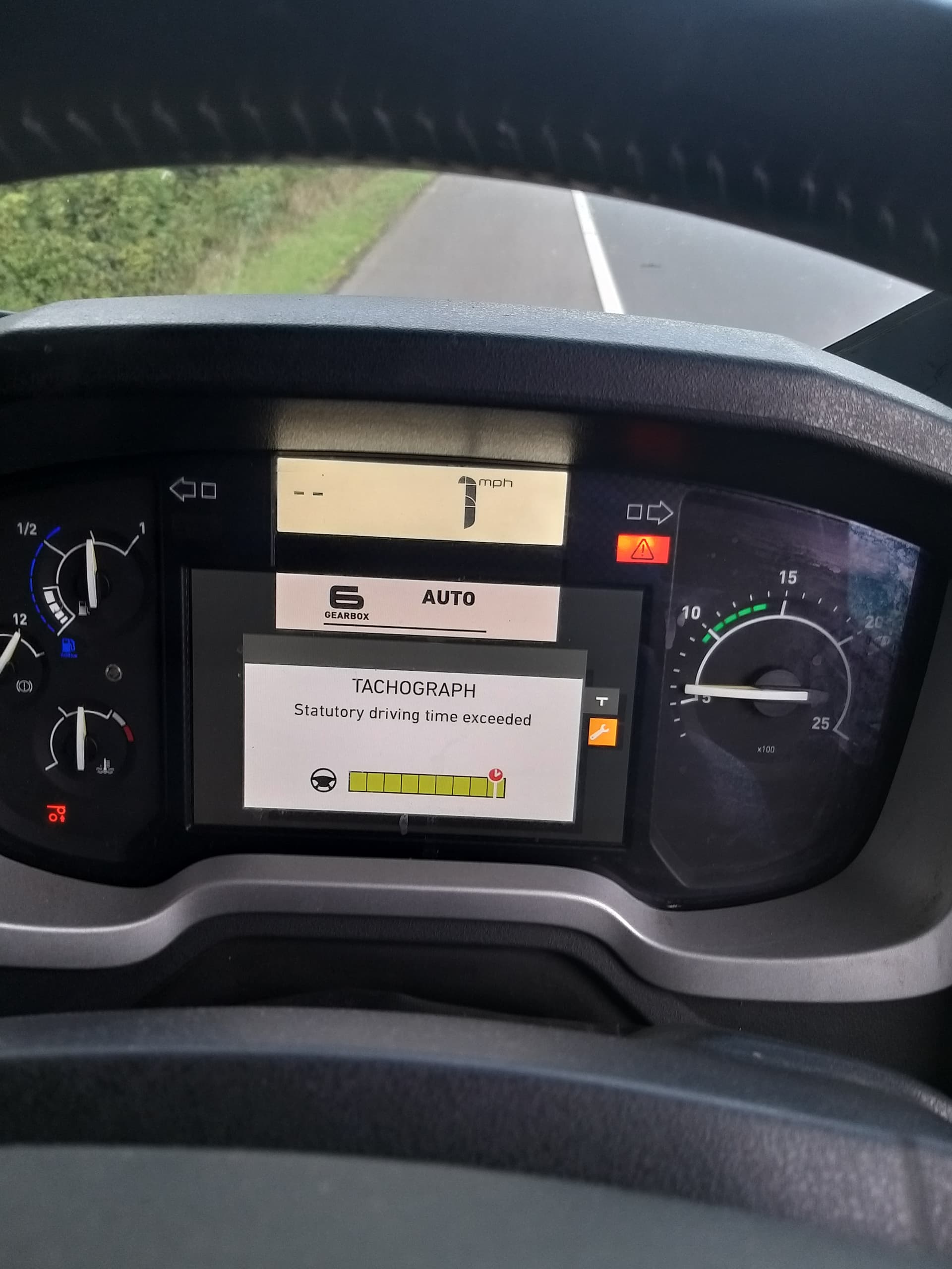

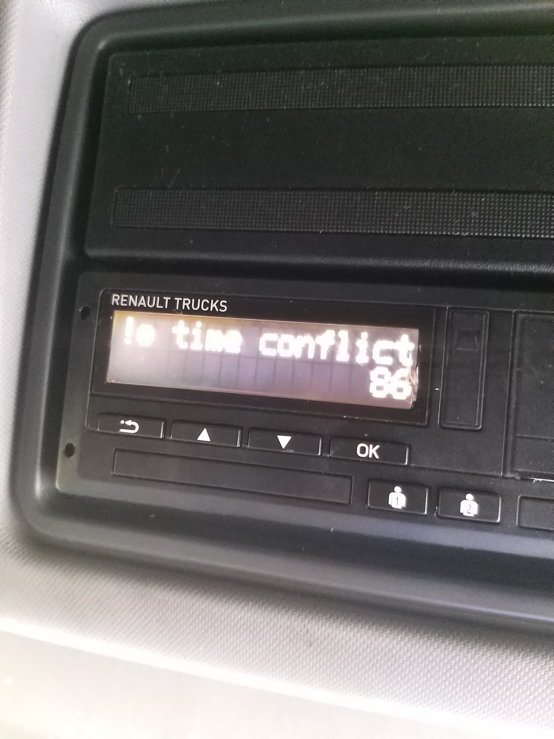

I woke up at Dorchester truck park on Friday morning.
Went to ‘book on’ at 6am, but tacho was showing a tine of 0020.
I just happened to scroll up on dashboard noticed it showed Sunday 14 Sept.
It has kept changing times ever since, went to a garage they could not get the time set right ot would not allow them to.

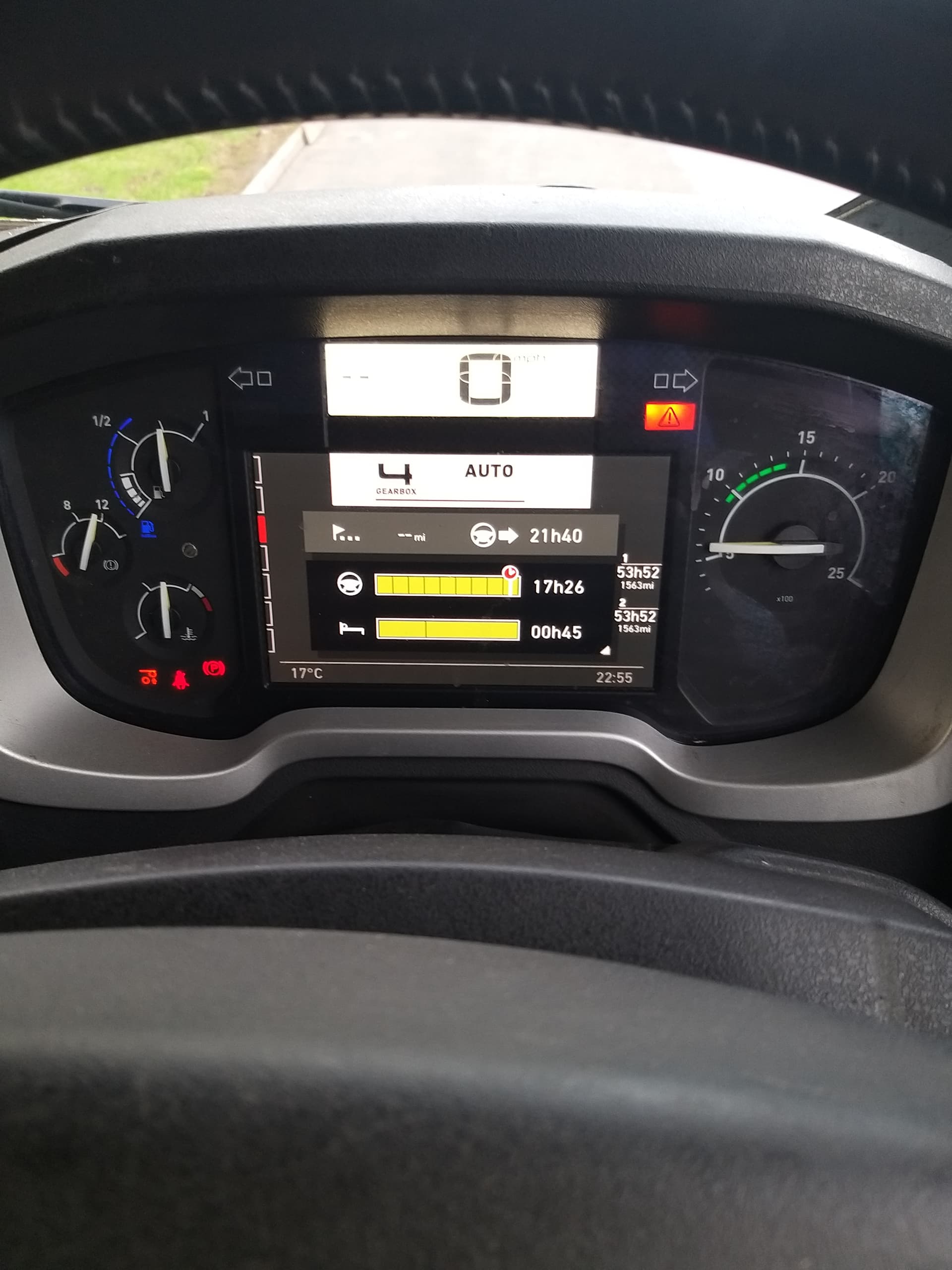

Got to yestrrday aftetnoon about 1600 dash warning telling me I’d done 17 hours driving (assume total of 2 days) and that my time was up.
Did all the necessary reporting faults to office, sending photos,.and printouts to cover my arse as far as I could.
Ran back today tacho was on correct date today, but clock 5 hours fast…put defect in for Mon.
Couldn’t give a toss about any forthcoming infringements,.what I do care about is I get paid off my tacho.:grinning_face:
