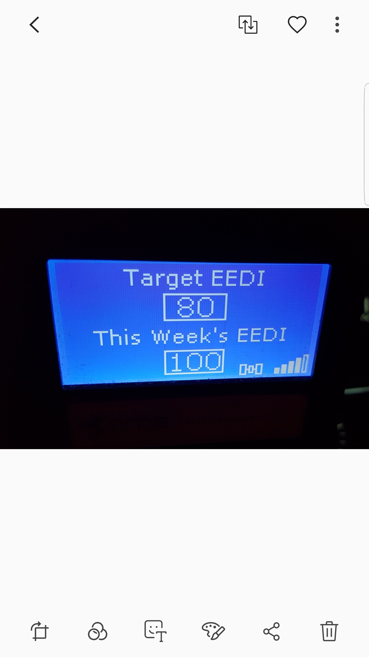

We’ve had EEDI boxes fitted on the dustcarts that beep at you for harsh acceleration/excessive throttle/harsh braking/idling and rate you higher when you stay in the green band more.
I hated them at first but they’ve defo changed my driving style and my fuel usage has gone down a fair bit. I now use the limiter and cruise control without even thinking - not for motorway etc but for urban driving.
