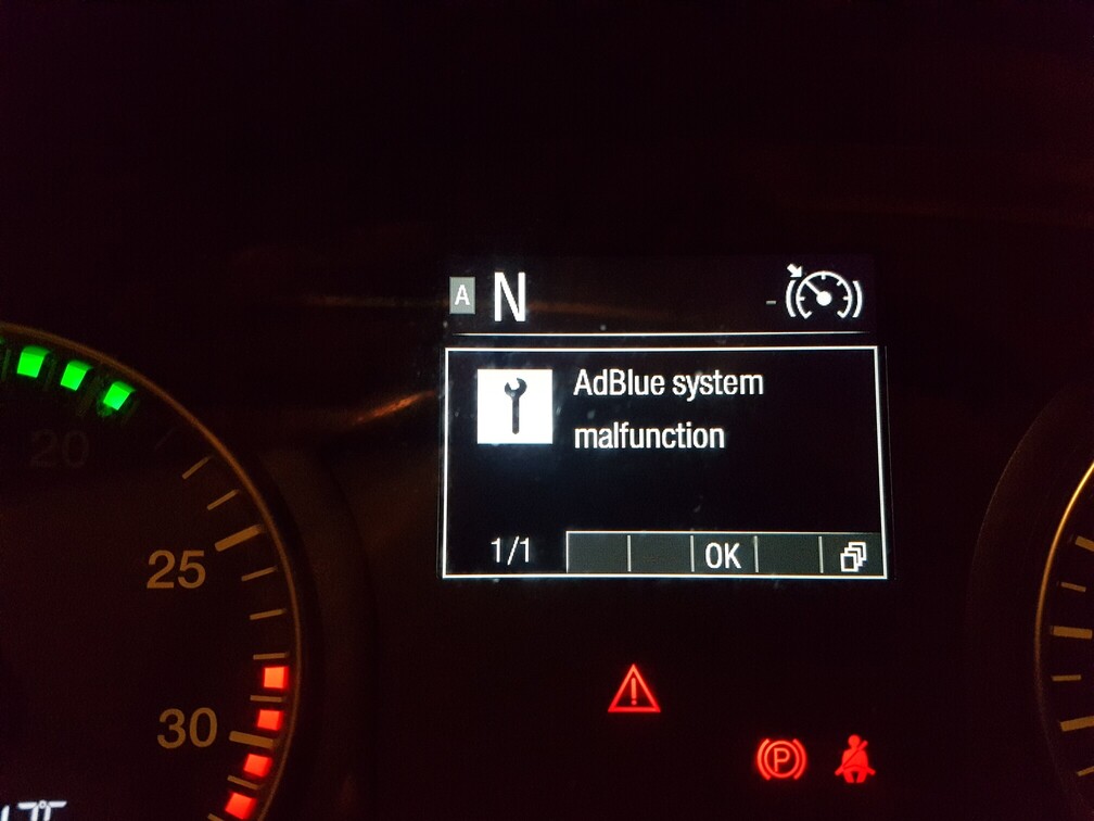

Anyone had adblue problems with a man tgm 18reg?
Before Xmas was getting adblue error warning engine malfunction.
And noticed needle won’t go below 3/4 s
Truck went to man dealer Trafford park they had it over Xmas new year
Got it back did the same again after a days driving.
It went back in again they had it for about 2 weeks got it back yesterday doing same again
Drive along and after about am hour lights up like a Christmas tree
If stop for a short while it seems to disappear.
Then after about an hour it lights up again.
Is serious doing my head it
It drives ok no problems.
Been to man Trafford park twice and they keep saying all sorted good to go bit obviously not.
Anybody had any similar issues?

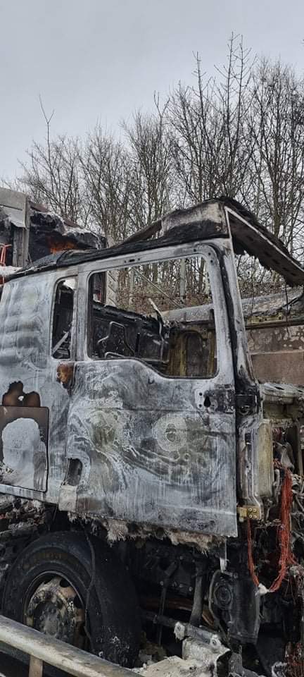

Ad blue and engine malfunction warning came up on one of ours on the M25 yesterday. Within 5 minutes of him stopping on the hard shoulder it went up in flames! It only came back from MAN Peterborough the day before where it had been taken to with the same faults.
This is it now.
the maoster:
This is it now.
That was an XPO MAN, I saw it going up in flames as I went past anti-clockwise [emoji54][emoji54]
