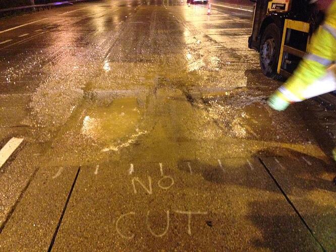

Great fun on the 25 Anti Clock near J9/Leatherhead, 06.00ish, saw about 30 cars & a truck on the hard shoulder, looks like they’ve all suffered punctures.
Police had just got there as I passed & were holding the traffic back.
This information has been brought to you via Viking Industries Travel information Division.
They just said that the road has collapsed between 10 & 9, so try to keep away !
Co’s you going anywhere.
They’ve been working there all night cutting out huge squares out of the concrete and filling them in.
I’m guessing the concrete hadn’t cured before they reopened the road tonight.
Not sure what they’re doing but it’s been going on a few months now.
I reckon the rain has washed it away then, it was peeing down from the early hours.
Looks like it
Just had a friend who knows someone whos car has been damaged. Its been setting off some air bags too as well as doing the tyres. Nice little bill for the Highways Agency to deal with.
Those pictures look press worthy to me, wouldn’t fancy hitting that at any great speed, I’m sure whoever signed off that work will be in for a rough time this morning.

Apart from the rain there were also a few differences to last night’s works. Most nights the concrete contractors were P J Davidson but last night I’m sure they had Axtel trucks doing the concrete. During all the time these works have been going on they have mainly used Davidsons. Also the tents they were using to cover the holes were nornally up but last night they were collapsed. They have gas heaters pumping heat into them and Im wondering if the heat had a chance to circulate around the tent properly to cure the concrete as it was only 6 inches above the hole instead of 6 foot.
