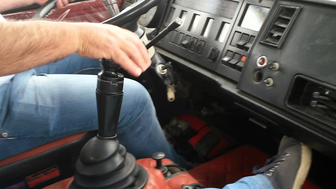

Some more Fiat V8/Fuller videos:
This bloke wins the prize:
[zb]
anorak:
https://www.youtube.com/watch?v=FN71Gk1BKGk
https://www.youtube.com/watch?v=qKm7yLKqtIk

Nearly all the Fiat V8 drivers give it a blip (or two, or three :smiley: ) to synchronise a change up. There are lots of Fiat V8 videos out there, which is nice- it’s not all Scanias.
To ease/speed-up the gearchange I would fit a two-stage return spring, with the detent set at just enough pedal to give, say, 1300rpm. It would then be a simple case of cutting the fuel, to get the revs dropping fast, then rest one’s boot on the “step” between the springs then, as soon as the stick went into mesh, bury the pedal.

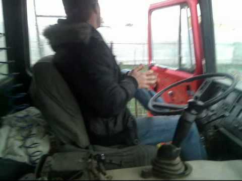

[zb]
anorak:
PMSL
https://www.youtube.com/watch?v=5mer1c2pYd8
No bonus points because he didn’t actually fall out of the open door making it the world’s oldest autonomous vehicle.While it just proves that Grappa is bleedin strong stuff and he probably won’t remember anything about it and will get a shock when he sees the vid and he’s sober. :smiling_imp: :laughing:
More Fiat V8/Fuller fun:
youtube.com/watch?v=iAeD51gspa8
This chap makes clean changes, but misses one, and ends up blipping the pedal. like the others. :smiley:
Question- his split changes are faster- is the splitter synchronised, or have I just blasphemed?
