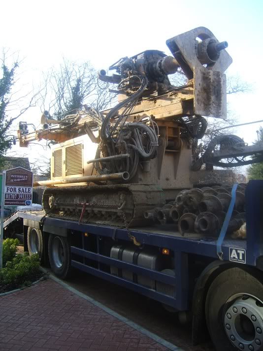

I have got some pictures of it with the Klemm loaded, I’ll try and get them on here.
Here are a couple of pics of it loaded with the Klemm rig, this is the one I move most and luckily it genrally goes on and off OK.
