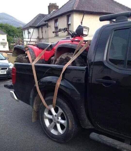

think this guy has failed question is do you stand and watch or do you step in and save his embarrassment ?
