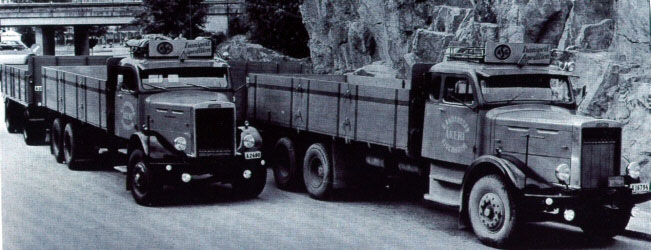

Leyland in Sweden
I found this image via William Weather Stones forum. he had driven Leyland when he was young. He talks about this.
I enclose the link: thedieselgypsy.com/Leyland% 20Hippo.htm
This photo shows Heyland Hippo or is it a Beaver? with a Swedish BeGe-sleeper who was based in Stockholm and ran for ASG (AB Swedish freight centers). They see high out when they have two steps to Volvo and Scania-Vabis one. Swedish truck looked like this with 90 cm high flaps around. Sure, do you think that the cab fits really well?

The nosbil eller torpedo or bonnet big Leylands are SUPER Beaver (4x2 ) or SUPER Hippo (6x2 and 6x4) these two in Sweden are Super Beaver with Rydds bogie add ons , also sold in Sweden were Comet 4x2 normal control or nosbil , trucks shown i foto have 201 HK (net) 0.680 (677 cu ins ) 11.1 liter diesel , so around 250 hk on the Swedish rating , and lots of low down torque , could pull away 50 ton without using the gas ,and wid a nice BE-GE cabin , maybe the worlds best heavy truck in the 1950`s ? ,one of the top three at the very least .

Interesting, I notice the trucks appear to have one piece windscreens was this a Swedish modification ?

The truck has Swedish BeGe cab and this brand has always had a full window, never two with a divider in the middle.

Leylands cab had a split screen but these two in Sweden have one of the many Swedish cabins available for any makes sold there , yes the first 0.680 was around 150 hk , but other settings were available , but all versions were much better in these super export models than UK versions as they ran cooler , look at the size of those radiators ! they were regarded by many heavy haulage men around the world as the best , but in the 1960s in Africa or Austrialia pulling very heavy loads (two trailers ect) they would seize up for no apparent reason , the quality was now in question , and in Africa Volvo gained with its Titan turbo as mr Pat Kennett was sent out there to find the problem for Leyland ,he concluded ...worn machinery ..not so fine dedicated workers or not so skilled ? .. of course Leyland had increased power on the power plus` versions largely by increasing RPM , the old non power plus 0.600 was only 125 hk @1800 RPM for 9.8 liters , but was a first class engine …Gardners cannot figure in this as they did no work at all …an empty truck was enough for them back then

Leyland Hippo.jpgIn a specification for the “Swedish” Leyland it stands:
Engine: 6 cylinder, direct injection diesel,
cyl-Vol. 11.100 cc, 154 bhp at 2000 r / m
torque 62.2 kgm at 1100 r / m, dry lining
Driveline: 5-speed synchronized, auxiliary gear box,
original rear axle: two driving axles with screw drive
Brakes: air brakes on six wheels, the total braking surface of 5.910 cm2
Suspension: bulb blasted semi-elliptic springs
General Characteristics:
Length: about 7341 mm
Width: 2320 mm
Distance between axles: 4,020 + 1,400 mm
Total weight: 21,600 kg
Weight: about 8.500 kg
Tire size: 10.00 x 20. 12 stocks
imposed load (incl. bed): about 13.100 kg
Turning radius: 10.5 m
The above information is Leyland’s own which have been translated into Swedish
13,100 kg is more than both Volvo and Scania-Vabis could bear. Weight is with bed. With bodywork falls the otherwise total load. Recall that my father’s Titan 1954 could load 11,750 kg so it’s 1350 benefit for Leyland favour. The Titan had 18,000 gross vehicle weight. The photo shows an elderly Leyland with an older GN cab (Gösta Nyström). Is there anyone who can appreciate the year with the help of the picture? I think it should be ca 1953.

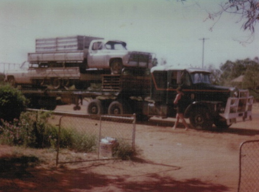

Its hard to say the exact year of the early Super Hippo in the photo , much later they got more modern front wings with headlamps built in , here is my model I built of one of the left hand control early versions that worked in England ,it had a double roof because it was built for some hot country , like a Volvo it would take any weight and the chassis would not break , many of these Leylands had two gear levers and 11 forward gears but constant mesh not syncromesh , also 5, 6 or 7 speed available all non syncro , a real drivers truck :sunglasses:
2.jpgHi All
This is/was my old Super Hippo Australian model originally fitted with a left hand Turbo 680power plus which really was a piece of junk but when Leyland replaced that engine with a conventional model with a Turbo from memory around 270hp 13speed Fuller Leyland reduction hub rear axles it was quite a good truck at the time late 70s early 80s ,the radiator was only 795square inches and although efficient in europe struggled in the summer months here with more than one trailer .
Sorry the photo is poor quality its the only one I have of the old girl and apologies if I.m pinching the thread just thought it shows the difference.
Cheers Dave

Thanks for that your quite correct the turbo models were the 690 I will put that memory lapse down to old age lol Leyland did try to increase the cooling here but they increased the capacity of the system by adding 2 extra rows of tubes which helped a bit but I had some success with a larger fan cowl and fitted a fan off an 8V71 Detroit 2 stroke engine, it was noisy but certainly moved more air through the radiator and kept it cooler.
We also fitted home made oil coolers on the engines which helped too.
We operated 4 of these trucks the first one was a 50s model with a 600 engine then a left hand turbo 690 which self destructed and had a conventional fitted under warranty followed by a Rolls Eagle mk3 set at 305hp went well at night with 3 trailers but had to be driven carefully when the sun came up.
The last one is the one in the photo.
Cheers Dave

Lilladan our Rolls didn’t have any Liner issues while with us but it did drop a valve,the memory has failed me again as to wether an inlet or exhaust but I do know the stem was Sodium filled and there was concern that we shouldn’t handle any engine parts until it had been thoroughly flushed with water, Rolls refused to accept warranty on the failure as Leyland Aus had fitted the engine with the standard Super Hippo radiator and they Rolls had insisted on a minimum of 1200 square inches frontal area. We weren’t happy so Leyland accepted the responsibility on repairs and some downtime but we traded out of the truck at the end of that cattle season and went to the Crusader chassis fitted with Detroit 8V71 engines.These gave good service in a tough environment.
I cheated with the sleeper cab it was off an S model Kenworth which I aquired quite cheaply and fitted to give myself a few creature comforts.lol.
Cheers Dave

Dig do you remember what diff ratio you had in that photo?
I think they would be 48mph diffs judging by the larger hubs, but it’s a bit hard to tell from the angle.

Cargo, 53mph at 2100 rpm, being old school I was content at 1900 which was around your 48 figure. I worked at Leyland Aus when I first arrived here and we actually modified the ERGO cabs to take a water pump mounted fan and a modified radiator to suit which greatly improved the cooling and popularity of the model but not enough for Leylands to change the european assembly line.
