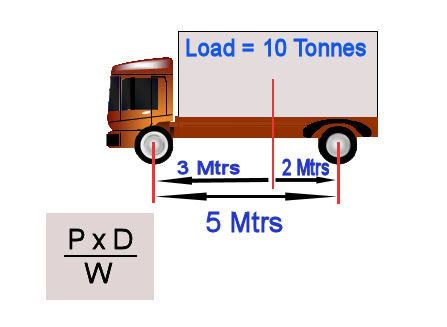

Here’s how to calculate the individual axle weights for a 2-axle rigid:
In this example, the kerbside weight including the driver is 8 Tonnes.
The load is 10 Tonnes, which in this case is evenly distributed, and the vehicle’s GVW is given on the plate as 18 Tonnes.
We now need to measure the distance between the centres of the axles to find the wheelbase, and found this to be 5 Mtrs as in the picture.
We now measure the distance from the centre of the load to each axle and found that in this case it is 3 Mtrs to the front axle and 2 Mtrs to the rear axle as in the picture.
Next, we use the formula in the picture, where
P = payload,
D = distance
and W = wheelbase.
So now to the calculation:
10 x 2 = 20 divided by 5 = 4 Therefore the front axle weighs 4 Tonnes and the rear axle must weigh 6 Tonnes.
NOTE: It doesn’t matter which of the 2 “distances” you use, but you should remember that the answer that you get will be for the “other” axle. ![]()
Doing the same calculation using the “other” distance will give you:
10 x 3 = 30 divided by 5 = 6 Therefore the rear axle weighs 6 Tonnes and the front axle must weigh 4 Tonnes.
If the load is of irregular shape, then you should adjust the “center” accordingly.
