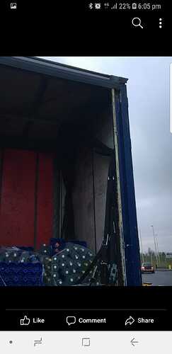

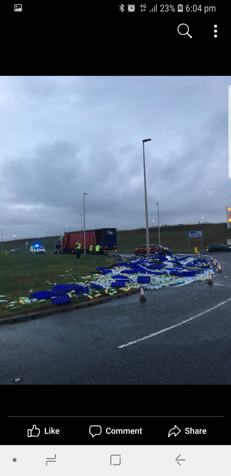

Leeming Bar lost load
Yep, those straps are great at doing their job…
If they’re used of course.
We often load drinks like this on those plastic pallets. I always get looked at by other drivers like I’m walking about naked when they see me putting straps on every pallet. :unamused:

Same here.
I usually stand up 2 empty pallets on the arse end of loads of pop or wines etc, and feed a ratchet strap through to bind them up, …as well as an internal both sides on every one.
We have the heroes who just cross internals on the back 2 and nothing else, as they… ‘‘Haven’t got a lot of time’’ :unamused: and need to impress the boss. :unamused:
Way I see it is if it takes an extra 45 mins to strap up, I’m on hourly pay, so these days I strap every bloody thing, why give the ■■■■ s an excuse to do you.
I bet he’s only just come out of the lemonade factory @ Leeming Bar. Probably the first roundabout.
Those bottles needed strapping. The plastic separators are designed to hold the bottles upright on the fork truck. I have carried tonnes of bottled water from France but it was shrink wrapped to the pallets and didn’t move. Those are very different.
