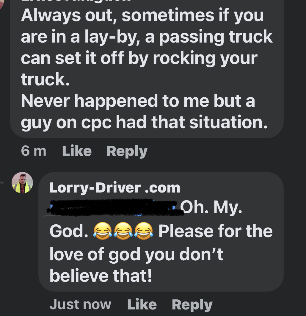

So on a Facebook page someone asked about leaving card in overnight when tramping, I leave mine in from moment I get in to moment I get out, weeks sometimes but many remove every day, down to what a driver is happiest doing or company rules imo. Then you get a comment like this. Just when you think you’ve heard every ridiculous tale going a new one pops up-
He is wrong, however I would take my card out in a layby just incase I’m in the middle and the truck infront moves and I’m on daily il move it cause I’m not a selfish cu nt. If I’m sleeping though I’m sleeping

You may not be selfish but you’re going to get nicked for falsifying or whatever.
Essentially you are claiming to be stopped on a break, but you are taking your card out to (unsucessfully) hide the fact that you have moved your truck whilst on a break.
Pedantic sure, but that is the way they will view it when they nick you.

Out of curiosity with your card in if you move forward 10 yards and pop tacho back on break to continue the rest period, could they tell under analysis?

Yes.
Realistically it woukdntvrecird anything on your tacho, you could move forward and pop it back on rest and in terms of the tacho head rest times etc would be unbroken so therefore it wouldn’t generate any report so therefore the average transport office type person wouldn’t have the gumption to think anything might be up.
But if the data was analysed by someone with a clue yes it would show up.

In a nutshell yes something to do with looking at the display in the driver 2 slot, on rest it will show rest in the driver 2 slot move forward and that rest is reset from the time that you moved an office download will not show this but when the head is downloaded in a roadside check it will show up if they look for it. The reason it doesn’t show up on your card is because the card is programmed to show what activity took place for the majority of the minute so 15 seconds on rest pull forward for 10 seconds go back to rest, majority of the minute has been spent on rest so that is what is recorded

Card In
The No1 display will show “Driving” for the few seconds you are moving. but revert back to Rest when stopped, and it will not show Driving on Driver Card*.
Card Out
If you move without a card in for a small distance and it will flash up “Driving Without Card”. That will be recorded on the head, and easily read off straight away from analysis or a simple printout.
Read the bottom of your daily print out. One minute video. Sec 0-40 last events from vehicle and driver are shown here.
Older details are easily available >Print>Events> Half a minute at the roadside, no equipment necessary.
Your card is in before and after “Driving without Card”, is going to prompt further questions.
Never try to hide anything. If you have a legitimate reason to move, no big deal, show it and explain it.
Hide it and they will be looking very closely at everything.
Ed. * the other posts are correct though, although it doesn`t easily show on card, if left in, it can still be found.
If card left in be careful of turn on ignition on daily rest as it defaults to other work, take care , B good Bobby.

If you are in the vehicle, best practice is to keep the card in. Robroy is right in that, if you move the vehicle without a card, that is technically a falsification offence. Much better to leave the card in and record a (very) brief interruption to daily rest or break. It’s still technically an infringement, but a much less serious one.

Pedantic sure, but that is the way they will view it when they nick you.If you are in the vehicle, best practice is to keep the card in. Robroy is right in that, if you move the vehicle without a card, that is technically a falsification offence. Much better to leave the card in and record a (very) brief interruption to daily rest or break. It’s still technically an infringement, but a much less serious one.
Exactly - a breif interuption of a daily rest with a printout to explain why is not a “serious” offence .
Pulling the card - moving the truck with no card in is fraud , falsifing records and can result(in serious cases ) in a jail term .
