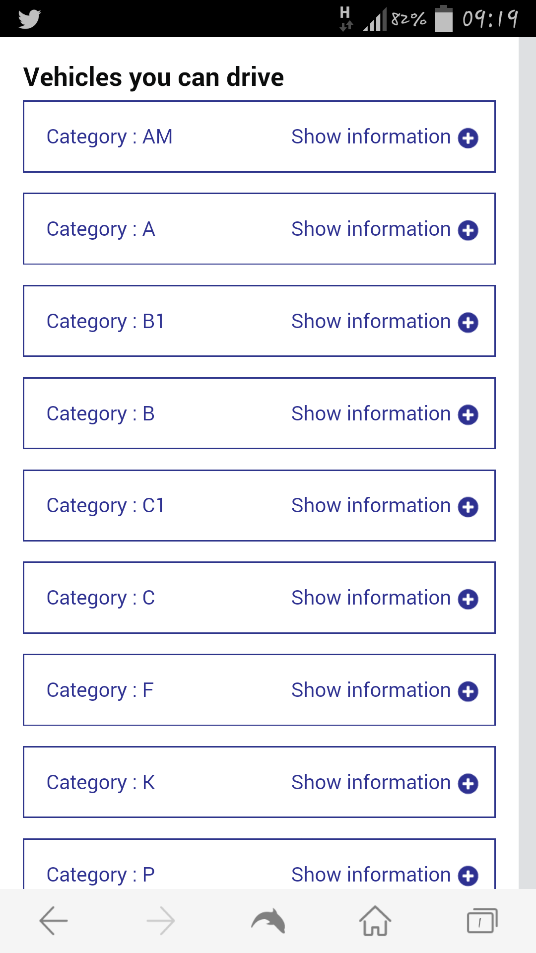

Yippee! My entitlement has been updated on the gov website. So I suppose the 3 weeks is a worst case scenario?
