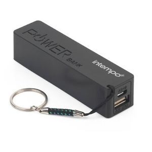

It would probably easier just to get one of those power bank thingies.
KCLeblanc:
The wife got me one the other month, comes in very handy, cheap as chips aswell!
Just had mine a month - brilliant. Yes, it’s got a torch built in.
Don’t leave home without it. Essential for cab hopping, agency etc.

TBH getting the socket fixed or the power bank is so much easier.

Lidl have power banks in at the moment , I bought one its great Especially as I have an I phone 5 and the battery life is dire :unamused:
Think it was about 7 or 8 quid .
