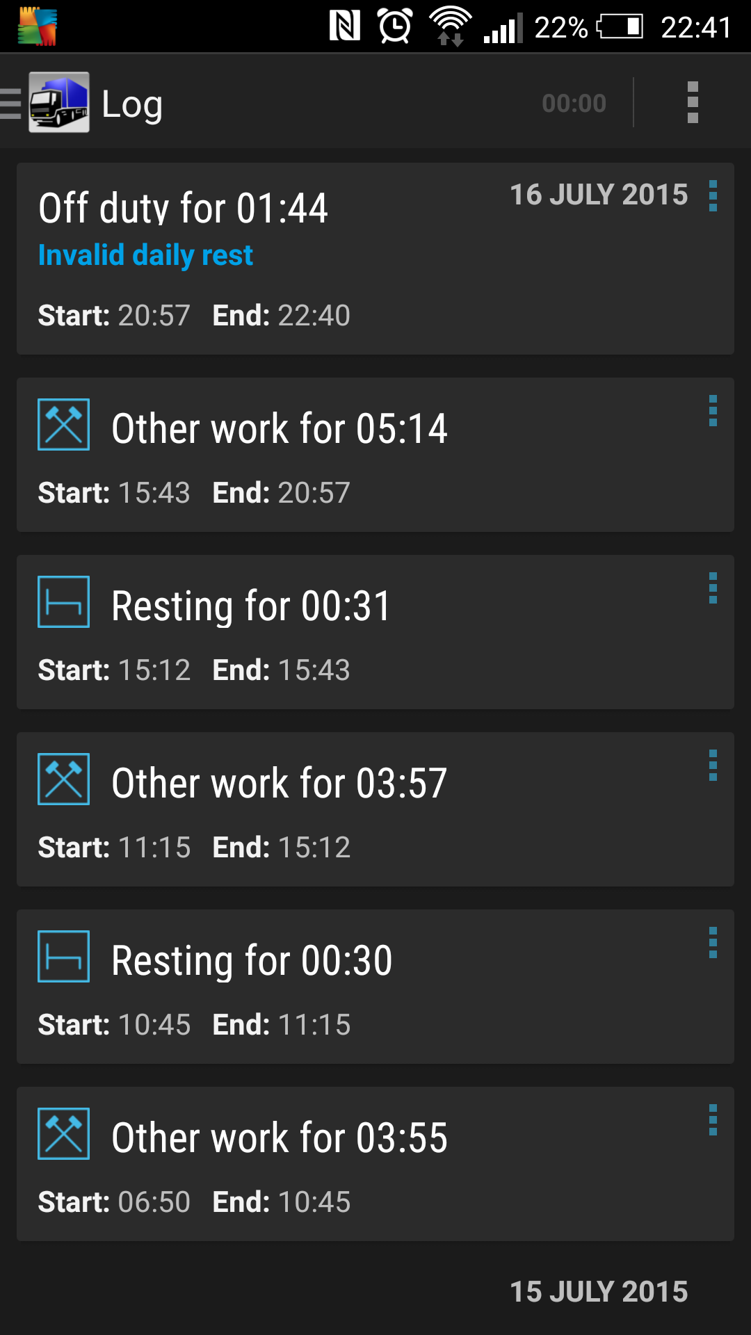

Is this ok for WTD 12- 15 hours
Hi i cant find much info about 12 - 15 hours wtd here is my total shift start 650 end 2057
Seems ok. Not sure about the invalid rest and off duty bit though.
Looks ok to me, you’ve not worked more than 6 hours without a break and you’ve had the required 45 mins break for a shift that is over 9 hours.
Thanks if mt total rest was only 45 min woyld that be 15 short or did my last " reset" the clock to the 6 hour rule again??
Thanks the invalid rest is just saying i havnt completed my daily rest yet
3stepsaheaduk:
Your first or last break could’ve been a 15 and you’ll have been fine.
I did a 15 spread with 2 45’s and still got an infringement on WTD. Never did find out why.
Where does the “off duty” part of the log come from? Something happened at 22:40 that interrupted/ ended your daily rest - changing mode? In some vehicles starting the engine can do that.
The off duty part is just the time i was looking at the log its just an app on my phone called trucker timer thanks for replies everyone
Is there any EU regs driving in that shift ?
Yes rog but i only record it on the app when using analogue tacho
