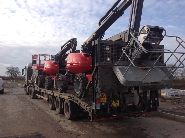

Let’s show you a couple of pics
Barge ![]()
That’s a mixed bag of gear there Mikey.
