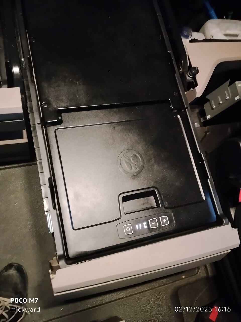

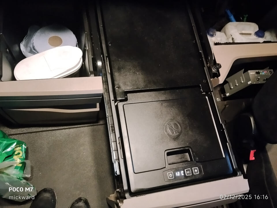

Got a fitted interior fridge, it keeps freezing stuff even though I’ve set it to not freeze. This seems to be a bit of a problem for MAN Trucks. Has anyone had any experience of this and had a cure?

It’s on 17 and freezing. And a 2021
17? Is it one of these? If so there is no 17 setting? https://www.man.eu/uk/en/service/coolbox_-30-l-121536.html
The lowest seems to be +2deg, but with a 2deg error, so as @blue_estate says, the sides will be well below zero, and cold spots are likely.
It’s not those the fridge extends out. But the one next to it is fixed in mine and wider, also my fridge is black I don’t know how to add an image in here. It seems to only accept links

Try setting to 40 and see what happens
Is there any letters on the screen C or F
If F then you will freeze stuff as thats -8 C
