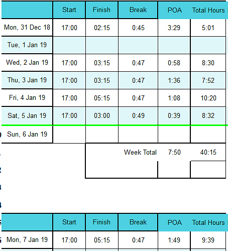

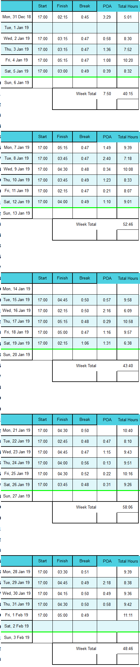

Hi, I always thought that working 2 consecutive 6 day shifts were legal as long as the difference from the reduced weeks from 45 hours were paid back by the end of the 3rd week as long as it was attached to at least a reduced daily rest, in 1 block. Maybe someone can take a look and tell me that ive missed something?

From your printouts it seems you have
regular
reduced
regular
regular
so all is ok so far on the first lot
Now the second lot
reduced
regular
reduced
regular
Still ok
Unless I am missing something ![]()
EDIT - YES I DID - I missed a week out of the calculations so ignore my reply as it is incorrect ![]()
Week starting 14 January you had a reduced weekly rest period of 38 hours 45 minutes.
Week starting 21 January you had a reduced weekly rest period of 37 hours 15 minutes.
That’s 2 consecutive weeks with only reduced weekly rest periods so that’s an infringement.
There are circumstances when you can have reduced weekly rest periods in 2 consecutive weeks but unless you understand how it works I would advise you not to.
Week starting 21 January you had a reduced weekly rest period of 37 hours 15 minutes.That’s 2 consecutive weeks with only reduced weekly rest periods so that’s an infringement

I’m wondering why the 2 weeks from 31st Dec to 13th Jan not thrown an infringement?
That’s 2 consecutive reduced weekly rests?
m3cab:
Still trying to get my head round this!!!I’m wondering why the 2 weeks from 31st Dec to 13th Jan not thrown an infringement?
You had the 13th and 14th off which counted as a regular weekly rest period for the week beginning on the 7th January.
Sent from my mobile.
week 31 dec to 6 jan = reduced weekly rest on mon 1 + sun 6
week 7 to 13 jan = regular weekly rest on sun 13 + mon 14
week 14 to 20 jan = reduced weekly rest on sun 20
week 21 to 27 jan = regular weekly rest on sun 27

Great info guys, our TM just says " Ehh…You cant do it cus Tachomaster says you cant".
Am i correct in saying that if Jan 6th and 7th were a regular rest, therefore making the 13th and 14th jan count as a regular for 2 weeks 14th to 27th jan, then the infringement in question wouldn’t have occurred?
m3cab:
ROG:
week 21 to 27 jan = regular weekly rest on sun 27that should be reduced?
21 to 27 is reduced - my bad AGAIN ![]()
I keep having to change between 2 tabs
m3cab:
A regular weekly rest period can only count for one week not 2 but I think I know what you mean anyway.
You are correct that if you’d had a regular weekly rest period on the 6th and 7th it would have counted for the week beginning on the 7th, the regular weekly rest period on the 13th and 14th could then have counted for the week beginning on the 14th resulting in no infringement.
