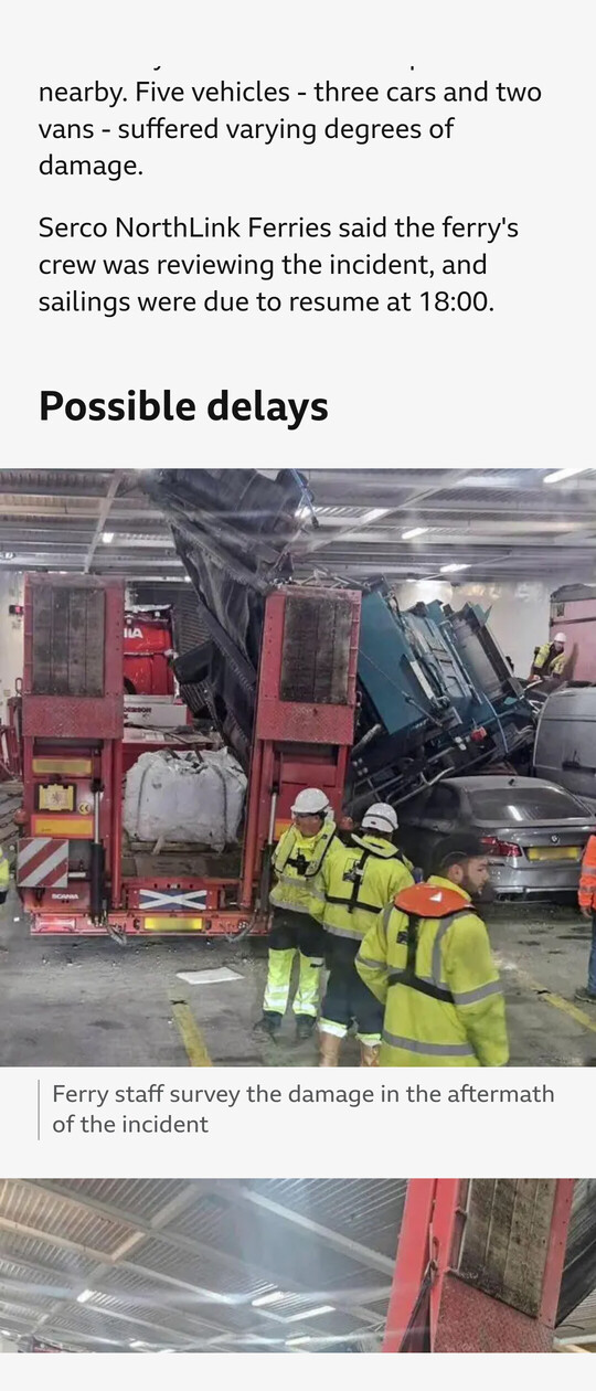

Low loader carrying machinery on Scottish ferry service . Load topples over during voyage landing onto cars..

Look at the number of chains seem to be hold the trailer down. Were those put on after the load fell off? If not then the crew were expecting a rough crossing.

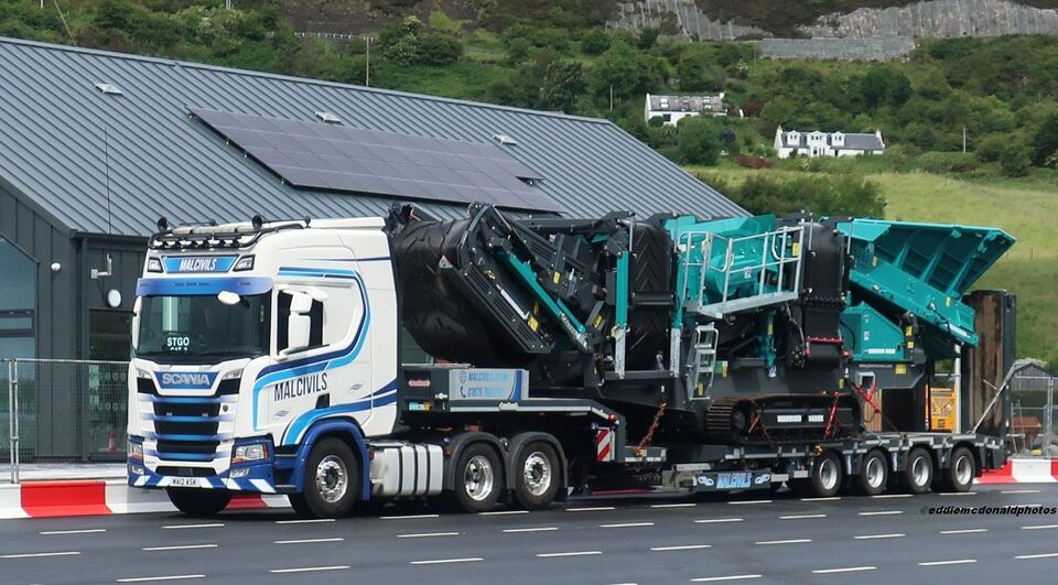

The load is a crusher similar to this one waiting at Uig Ferry Port Isle of Skye for the 1hr 45min crossing to Lochmaddy Ferry Port Isle of North Uist Outer Hebridies June this year.
Imagine if the cars weren’t there to cushion the blow as it tipped over.
If cars weren’t there could maybe caused serious damage to the ferries floor /hull
Whoever owned that beemer on the rhs of the trailer can vouch for that! :wink:

On a serious note, I see some of the chains on that trailer in the Mac Civils pic are running from the trailer outward to the load, I’m inclined to think that would be less able to withstand force sideways on the cargo, but not sure if that has real basis or not.
I would guess that the problems with that type of load, especially on a ferry, would be high C of G and no sideways resistance on the cat tracks.

From that piccie we can’t see what is under the load.
There could be paired chains pulling the load across the load (crossed from opposite sides) holding it in place.
In the BBC link there appears to be a rubber anti slip mat there? If so good.
