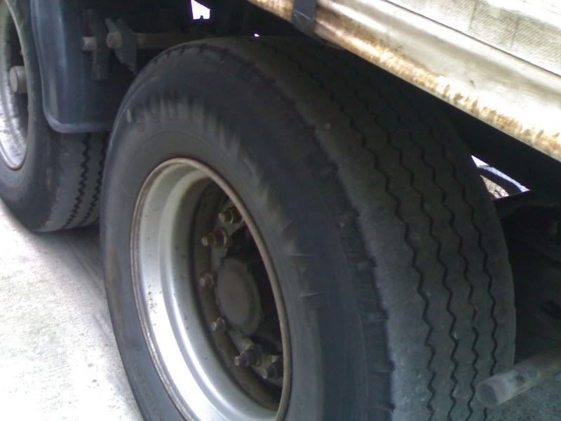

If you got stopped by vosa with this
What it should look like
PG9 id assume? A fine for the driver?
The only reason i ask is because this is happening quite often, we have standing trailers at a 3rd party site. They like to rip mudguards off in their spare time. This site is 70 miles away from the garage we use - so the call out charge would be high id suspect.
So if you where stopped by vosa but you where actually taking it to the garage would that make any difference?
Where does a driver stand on this? Just refuse to take it on the grounds it is a PG9 defect?

Yep.
More than likely to be issued with a delayed prohibtion, but then again depends on the vostapo which pulls you :cry:
a driver from our yard got PG9 for this.
sure there is a FPN for “inafective spray suspresion equipment” or words to that effect
it is a delayed PG9 just for having the spray suppression flap missing, let alone the wheel arch itself :open_mouth:
and i would refuse to take the trailer
I got a PG9 from a split spray flap bout 2 yrs ago now :confused: ,so i’m pretty sure this would warrent a PG9. But like has been said depends on the person that pulls you over.

I would refuse to take the trailer till they had fixed it.
Also as said get the mud flaps shorternd it will stop the problem a bit.

Ditto
I had a similar situation the other day. Was asked to pick up a trailer without a mudguard and take it to the yard that does our repairs. As long as there is a defect notice written, and you are on the way to get the trailer repaired, VOSA would not give you an infringement… But I wasn’t stopped, so I didn’t find out if that was correct advice!

As per the picture then it will be a delayed prohibition and a £30 FPN. If the wing was still attached but was likely to come off at any moment then it’s an immediate prohibition and a £60 ticket.
