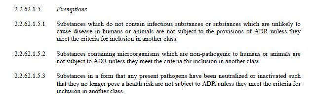

It could be difficult to find it in ADR, it is like looking for the UN number for Strawberry Jam or Marmalade
hse.gov.uk/cdg/pdf/infect-subs.pdf
However I believe the answer is contained here, but I am always willing to learn.
Just remember if the consignor tells you it is not classified or non hazardous, the driver is in the clear, it is not their responsibility

Hi nedflanders,
Wheel Nut has this one spot-on, including the link to Section 2.2.62 of ADR.
There is no link to prove this except the one already provided, because ADR contains a list of substances classified as “dangerous” and I can tell you that the ‘stuff’ in question is not on that list.
I understand that word of mouth might not work at all times, but I’ll add that I’m a qualified DGSA and ADR instructor, so I hope that will be good enough. :smiley:
