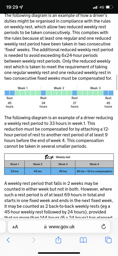

^^^^^ Assuming that he had a regular weekly rest period last weekend, if he has a regular weekly rest period after next Saturdays shift he will have complied with the regulations that say you must have at least one regular weekly rest period in two consecutive weeks (paraphrasing).
Nowhere do the regulations say you cannot have two consecutive reduced weekly rest periods.
I’m well aware of that, the link I posted shows a graphic where there are two consecutive reduced rests.
Is it really safe to assume he had a regular weekly rest the previous weekend when he’s asking if he can do the shifts he wants to? Whatever the reality is of “The Poster Known as Dozy”, his reputation, plus his current question, wouldn’t inspire me to assume anything with any degree of confidence.
I never explained what I meant very well, if the OP had a regular weekly rest period last weekend and has a regular weekly rest period after next Saturdays shift he will have definitely complied with the weekly rest requirements.
If he had a reduced weekly rest period last weekend and this weekend then he may already have an infringement notice on the way.
Either way it wont make any difference to whether or not he can work next Saturday, as long as he has a regular 45 hour weekly rest period after next Saturdays shift that regular weekly rest period can count for the coming week (19th to 25th December) if necessary, so in the two week period from the 12th to 25th December he will definitely have had one reduced and one regular weekly rest period.

What about this then
robthedog:
Yes, all the know it calls, usually giving forth their knowledge, seem to forget that the weekly rest reduction needs to be compensated. In one lump, added to another weekly, or daily rest.
All this, is first day, basic knowledge, that any driver should know. It’s not rocket science.
