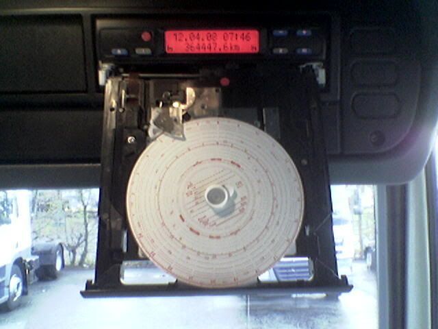

Hey guys. Today ive been driving merc axor. These mc kenzie or kenzie pull out analouge digis. How da hell am i suppose know what ive drove?
are you kidding :open_mouth:
No im not kidding. Have you seen the buttons on it? Other digi ones you push the down button and can check the driving you have done. Cant seem to do this on that kenzie or what ever the crapy thing is. Now im not talkn about analoge one goes into the dash old style. Im talkn about the digi type

You need to be a bit clearer Davy, we still don’t know if you’re talking about a digital tachograph or an analogue tachograph.
If it’s a digital tachograph it will almost certainly be a Siemens or Stoneridge, as far as I’m aware there is only Siemens, Stoneridge and Actia, and so far I’ve never even seen an Actia in a lorry.
If it’s the analogue tachograph it will most likely be similar to the one above (first image).
the following 2 pictures show what an ANALOGUE tacho look’s like
where the you need to count the hours dependent on the movment of the truck … the best way when using an Ann tacho is to write your times down or get a clock as said …
you might have to enlarge the picture to read it easier… an analogue taco will NOT count up your hour like a DIGI will
Pretty sure it’s an analogue going by this picture… But why say digi right after analogue? :open_mouth: It’s a bit like talking about the minute hand on a digital watch…
Djc you nailed it. Thats it
DJC:
As it looks like a digi but is in fact an analogue ( was used as the crossover from analogue to digi IIRC )

While using an analogue tachograph you need to keep a record of your driving hours and breaks as you go, some people used to use a timer and notebook to keep track of how much driving they’d done.
If you want to know how to read a chart to work out your driving time:
Each of the short lines on the outside of the chart is 5 minutes, the thick line near the inside is driving time as marked on the image, use a ruler or straight edge from the centre of the chart to read how much driving time you’ve done.
Be careful not to damage or erase any part of the graph as you check it.
