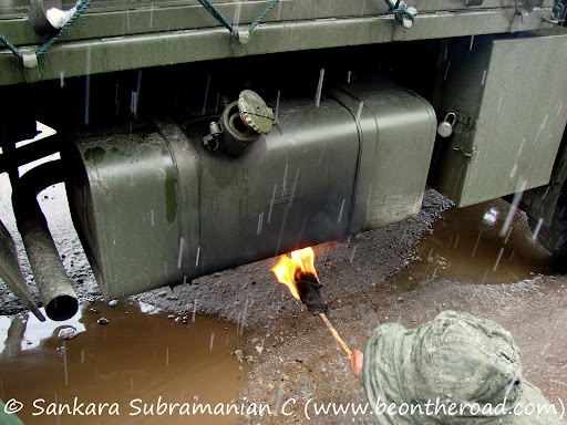

Someone must have a photo of an old tyre burning under the tank :laughing:
