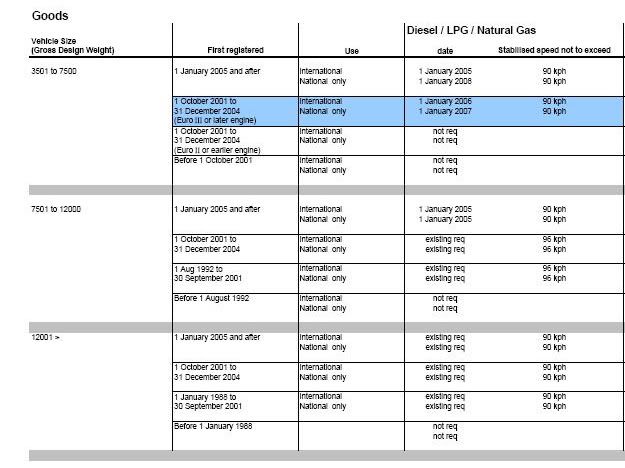

Quinny:
So what age of vehicle are we looking at here Denis,before the rules apply?
Ken.
I’ve had this in my photobucket album for a few years - think it explains it
hope it’s not out of date
              So that Diagram that denis put on means I could by a 1987 Scania 142 and a speed limiter exempt?
