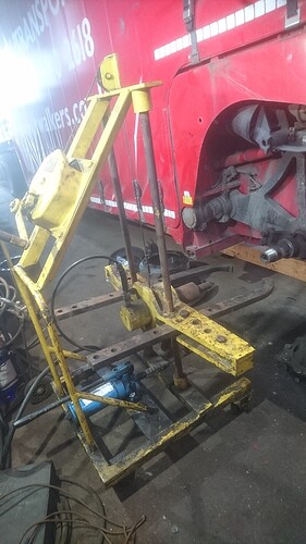

The worst I’ve worked on are Gigant for sticking on the bearings, having said that when there’re put together new they only use a bit of that poxy white anti seize grease that goes a sticky chalky texture and lets damp in resulting in rust between the bearing race and the stub axle, we’ve had to cut 2 off a 3 year old trailer as my puller broke the hubs it must be in the region of 40/50 ton pull

0Worked on quite a few SAF axles though usually drum brake set up, not had that much trouble with the hub nuts, we tend to put them together well greased up, including the stub axle and behind the hub nut, we also don’t bother torquing them up to silly settings as the N/S are usually left hand thread, not had any mither of them coming loose.
Now thats a real mans hub puller.
The worst I’ve worked on are Gigant for sticking on the bearings, having said that when there’re put together new they only use a bit of that poxy white anti seize grease that goes a sticky chalky texture and lets damp in resulting in rust between the bearing race and the stub axle, we’ve had to cut 2 off a 3 year old trailer as my puller broke the hubs it must be in the region of 40/50 ton pullNow thats a real mans hub puller.
Big boys toy for sure. It has the look of something that a clever engineer had made, out of his head.
Yes it’s some tool, picture doesn’t really do it justice, it’s got to be 5ft high, I tend to unbolt the pump and move to the side when things are obviously very tight as a hub can accelerate at an unbelievable speed from being stuck!
