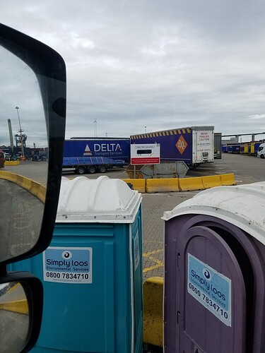

The trailers don’t have the trailer brake on because it’s a Ro-Ro terminal. They actively ask you not to use them. It’s written in big letters at Dockside.
Get a photo of that sign cos I’ll hazard a guess it might be disappearing soon.
They have basically made a rule that goes against one of the main safety rules of hooking up.
I can understand why from their point of view but I wouldn’t like to have to be stood explaining why “my site rules” overrule a prime safety guideline, which has been mentioned is an instant fail should you not follow when obtaining the license.
Here you go ,purfleet dock
That sign is interesting as it doesn’t say not to APPLY them. It just says not used. Could be a defense that they sid it to warn the driver to check as he assumes it is not applied rather than assume it is.
Personally if I drop a trailer the brake goes on. Simple as that
