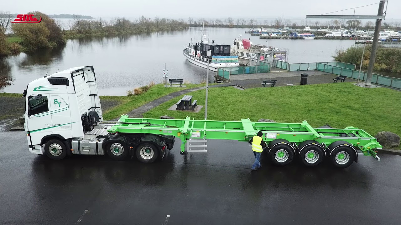

I just passed my test and on agency and have a slider trailer with a 20 ft container sitting in the middle. How do I move the container to the rear for when I get to my delivery please ?

Either
Pull the trailer brake and push the other button beside it in. The pins will retract. Then get in the cab and reverse. The trailer will shorten. Then get out, open the doors, pull the locking pin putton out, put the trailer brake off and reverse into position.
On any skelly trailer ive used, there is a housing on the offside just before the front axle which has a red button for the brake and the other is black, which is the locking pins button. You cant retract the pins without putting the brake on.
or
Take the red airline off, put it on the other line housing and the pins will retract. Reverse to shorten the trailer then put the red line back on the original housing and put your trailer brake off.
Make sure the trailer is level and definitely not on a slope or leaning either too far left or right. The pins might not fully retract, or one will and the other wont.
If you are on the flat and the havent retract, try reversing and pulling forward. This might free it up.
If the container is heavy, it might need a bit of welly as well.
One more thing, at the back there are twist locks for 40’ containers. You need to take the pin out, turn the housing over (lift it and let it back down at the back of the trailer) BEFORE you move the container back. Itll damage them if you dont
And only reverse in a straight line when shortened
Try to get as close/straight onto the loading bay before you shorten the trailer as manoeuvring can be a tad difficult if the 20ft is heavy…
Also as said above
CHECK REAR PINS (40ft) ARE DOWN BEFORE ANY BUTTONS ARE PRESSED…
