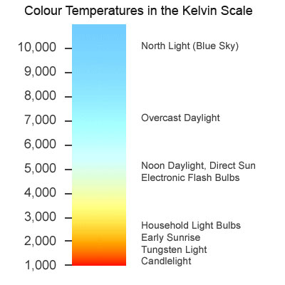

Partly true, however they are NOT legal as a retro fit, my car has gone through 3 MOT’s with them no problem and i have never been flashed by other motorists with them fitted, but this does not make them legal.
4300K is the whitest and brightest you can buy, 6000K has a blue tinge to them and the output is reduced slightly, 8000K are quite blue.
This is the Kelvin colour scale:
