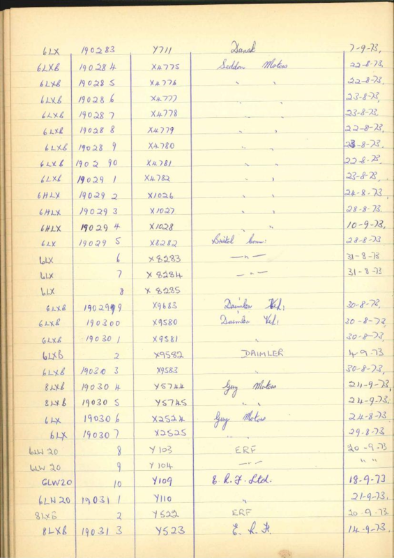

These dispatch records are fascinating documents,not only do they clear up the Guy Big J Gardner 8LXB Tractive Units mystery,but they also document a lot of Gardner Diesel Engines that were also dispatched to Atkinson Vehicles,Bristol Commercial Vehicles,British Leyland,Daimler Transport Vehicles,ERF Ltd,Fodens Ltd,Scammell Lorries,Seddon Motors and other companies.

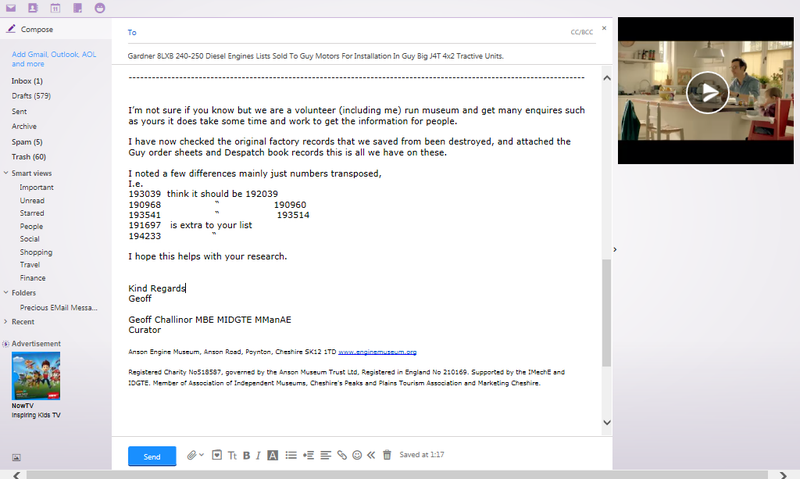

Geoff also EMailed an Anson Engine Museum Form.
Geoff’'s EMail letter to me:-
#Gardner.Gardner.EMail UK To Me From Geoff Challinor MBE MIDGTE MManAE,Curator Of The Anson Engine Museum,Regarding Sales Of Gardner 8LXB 240-250 Diesel Engines To Guy Motors.1.

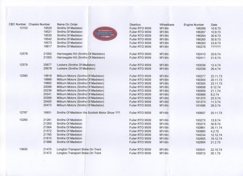

The British Commercial Vehicle Museum - BCVM list of all the 29 production Guy Big J 4T Gardner 8LXB Tractive Units built:-
#Gardner.Gardner.Guy Big J4T 8LXB 240-250 Eight-Cylinder In Line Diesel-Engined 4x2 Tractive Units Production Details,Chassis Nos,Engine Nos,Dates,Operators,etc,Guy Motors archives,British Commercial Vehicle Museum.1.

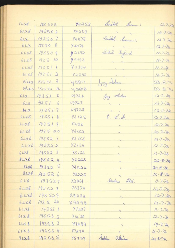

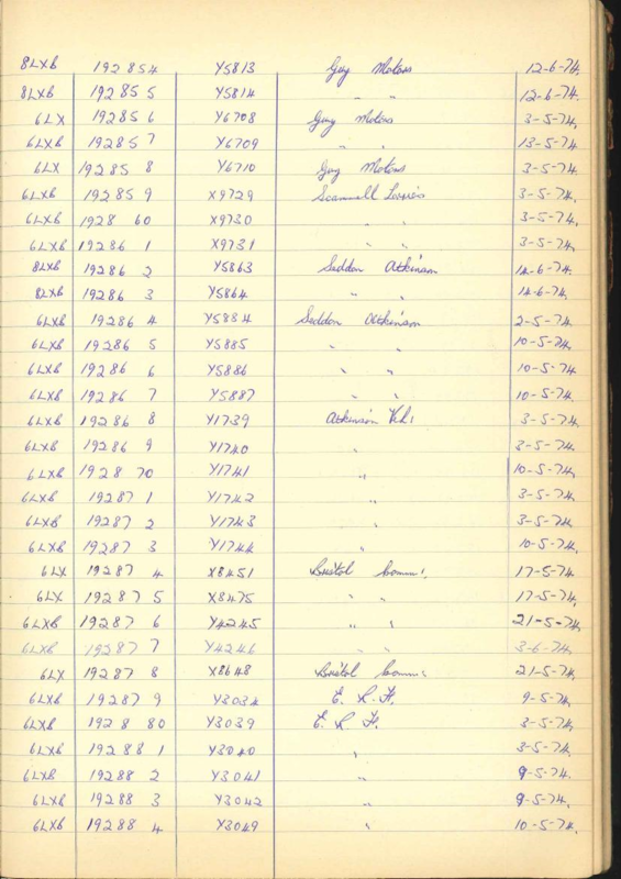

The twelve pages of Gardner Engine Dispatch Records which are relevant to Guy Motors:-
(NOTE 1:The engine numbers logically follow each other in ascending order,BUT some of the dates at least are seemingly back to front
(NOTE 2:The third column is the dispatch number)
1.
Engine Numbers: 186255-186285
Dates:21-11-1972 - 7-7-1972
#Gardner.Gardner Dispatch Book Listing 8LXB 240-250 Eight-Cylinder In Line Diesel Engines Supplied To Guy Motors,For Guy Big J4T Tractive Units.1
Engine Numbers: 190252-190282
Dates:18-8-1973 - 7-9-1973
#Gardner.Gardner Dispatch Book Listing 8LXB 240-250 Eight-Cylinder In Line Diesel Engines Supplied To Guy Motors,For Guy Big J4T Tractive Units.2
Engine Numbers: 190283-190313
Dates:7-9-1973 - 14-9-1973
#Gardner.Gardner Dispatch Book Listing 8LXB 240-250 Eight-Cylinder In Line Diesel Engines Supplied To Guy Motors,For Guy Big J4T Tractive Units.3
Engine Numbers: 190590-190620
Dates:12-10-1973 - 15-10-1973
#Gardner.Gardner Dispatch Book Listing 8LXB 240-250 Eight-Cylinder In Line Diesel Engines Supplied To Guy Motors,For Guy Big J4T Tractive Units.4
Engine Numbers: 190931-190960
Dates:26-10-1973 - 7-11-1973
#Gardner.Gardner Dispatch Book Listing 8LXB 240-250 Eight-Cylinder In Line Diesel Engines Supplied To Guy Motors,For Guy Big J4T Tractive Units.5
Engine Numbers: 191364-191394
Dates:27-11–1973 - 13-12-1973
#Gardner.Gardner Dispatch Book Listing 8LXB 240-250 Eight-Cylinder In Line Diesel Engines Supplied To Guy Motors,For Guy Big J4T Tractive Units.6
Engine Numbers: 191674-191704
Dates:21-12-1973 - 17-1-1974
#Gardner.Gardner Dispatch Book Listing 8LXB 240-250 Eight-Cylinder In Line Diesel Engines Supplied To Guy Motors,For Guy Big J4T Tractive Units.7
Engine Numbers: 192389-192419
Dates:26-3-1974 - 29-3-1974
#Gardner.Gardner Dispatch Book Listing 8LXB 240-250 Eight-Cylinder In Line Diesel Engines Supplied To Guy Motors,For Guy Big J4T Tractive Units.8
Engine Numbers: 192854-192884
Dates:12-6-1974 - 10-5-1974
#Gardner.Gardner Dispatch Book Listing 8LXB 240-250 Eight-Cylinder In Line Diesel Engines Supplied To Guy Motors,For Guy Big J4T Tractive Units.9
Engine Numbers: 193257-193287
Dates:3-7-1974 - 21-6-1974
#Gardner.Gardner Dispatch Book Listing 8LXB 240-250 Eight-Cylinder In Line Diesel Engines Supplied To Guy Motors,For Guy Big J4T Tractive Units.10
Engine Numbers: 193505-193535
Dates:12-7-1974 - 20-8-1974
#Gardner.Gardner Dispatch Book Listing 8LXB 240-250 Eight-Cylinder In Line Diesel Engines Supplied To Guy Motors,For Guy Big J4T Tractive Units.11

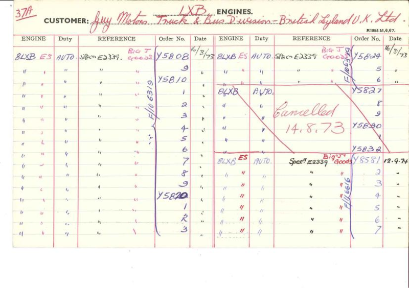

Gardner Engine Order-Sales To Guy Motors Cards:-
6 Gardner 8LXB Engines bought by Guy Motors.
#Gardner.Guy Motors Order Card Listing Gardner 8LXB 240-250 Eight-Cylinder In Line Diesel Engines Supplied To Guy Motors,For Guy Big J4T Tractive Units.13
12 Gardner 8LXB Engines bought by Guy Motors.
#Gardner.Guy Motors Order Card Listing Gardner 8LXB 240-250 Eight-Cylinder In Line Diesel Engines Supplied To Guy Motors,For Guy Big J4T Tractive Units.14
26 Gardner 8LXB Engines bought by Guy Motors. A separate order for six 8LXB engines was cancelled.
#Gardner.Guy Motors Order Card Listing Gardner 8LXB 240-250 Eight-Cylinder In Line Diesel Engines Supplied To Guy Motors,For Guy Big J4T Tractive Units.15
13 Gardner 8LXB Engines bought by Guy Motors.
#Gardner.Guy Motors Order Card Listing Gardner 8LXB 240-250 Eight-Cylinder In Line Diesel Engines Supplied To Guy Motors,For Guy Big J4T Tractive Units.16
Total number of Gardner 8LXB 240-250 8-Cylinder Diesel Engines bought by Guy Motors is 57! ![]()

Well it’s taken over 7 years and 123 pages of debate to arrive at this comprehensive and well documented conclusion, and many thanks to “Valkery” ! Although I never disputed that there may have been an 8LXB GUY Big J produced it was just that there was a complete dearth of any concrete evidence to support the fact but the documentary evidence clearly shows that Guy received 57 8LXB engines over the period listed of which S O M were by far the largest recipients so where did all the others go ? It is reckoned that all these 8LXB’s were built by a “Ghost Squad” at Fallings Park which is why no photographic evidence is available
 However, the effort that has gone into producing this documentary proof has got to be applauded and is most interesting and thoroughly appreciated. Thank you, Dennis.
pete 359:
hi dennis
i like everyone else has come across big j’s with several different types of ■■■■■■■■■■■■■■■■■■■■■ and gardner’s,but i personally have never seen one with the 8 cylinder 240! apart from the one parked outside elvis’s chipshop in grimsby!![]()
regards andrew
