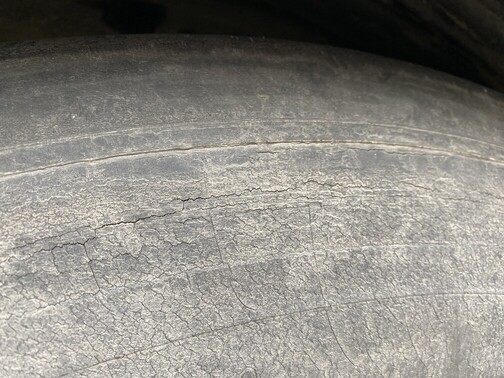

This is what i came across today, this was on the very back axle on a tri axle box trailer, i did defect it. I do agree, any tyre A decade old should be replaced.
