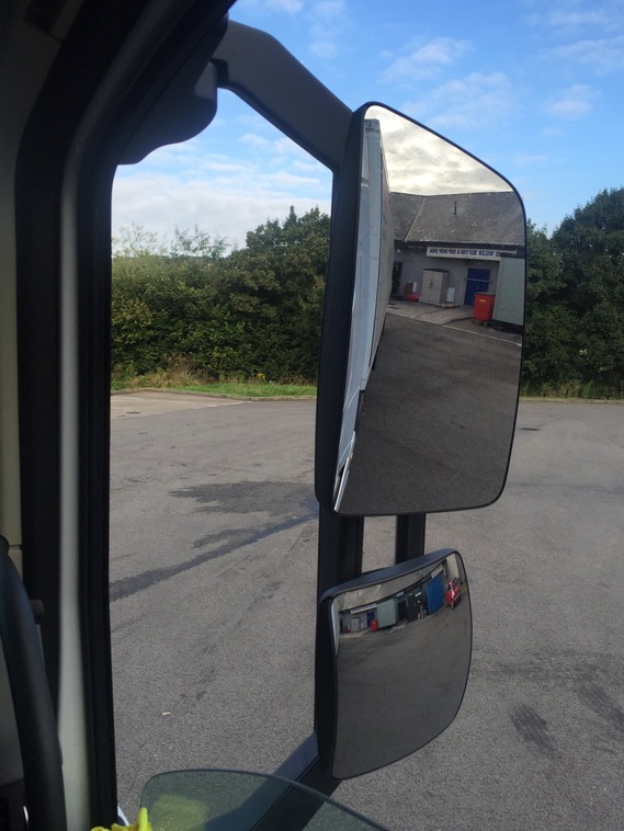

Exhibit A, correctly adjusted mirrors

Oh and @ Luke your mirrors are a fraction out, but I’ll put that down to camera angle. That wouldn’t be a Volvo FH16 750bhp jobby would it. :wink:
