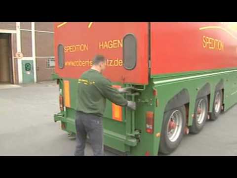

as ive just started on the glass ive had a couple of questions about how the trailers work.
the unit and specialist trailer.
first you open the back door which also goes towards keeping the trailer square and holds the 2 sides together, and take off the hydrauilc pads off hold the glass in place and take out the mats and bars.
then round to the control panel lower the trailer at the front and back. then when stillages is sitting on the floor you pull forward leaving the stillage where it sits.
the factory will then tip the stillage. when empty reverse back under it close the 2 front airbags and put locking bars on the front trailer axles so when you lift it all back up the front wheels come up as well.
very good would be better if you could video the action.

gazwrf:
i will do that this week.

http://www.youtube.com/watch?v=c15UIb9_y5gCheers!
CD…
from viewtopic.php?f=2&t=62044
this video from the same uploader on Youtube shows the mechanism a bit better  but with Paper
 but with Paper
Cheers dave that saves me job. That exactly how it goes.
that looks a very heavy trailer for the amount it carries jd what weights do you get?? how difficult is backing over the stillage to collect it again??
steve07:
I think your underestimating the weight of glass  its very! heavy!
 its very! heavy!
im always grossing out at over 43 ton and just a smigin under 44.
when you drop the stillage for tipping you only pull out enough for them to tip it so you can stay in line. problem sometimes you do stillage drop and swaps and then it can be difficult to line up for the empty stillage and if its offset it pushes the sides of the trailer apart which is then difficult for putting the bars back in.
