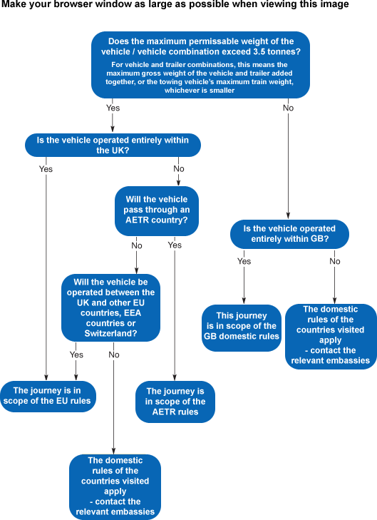

For speed, I’ll link to a picture which gives a flowchart showing which rules are which:
drivingtheory4all.co.uk/Lear … es-Ove.gif
This is actually for GB, EU and AETR rules and doesn’t include certain extras such as I believe milk tankers and some utilities company work which seem to run under GB rules, but it gives a pretty good starting idea for the majority of cases.
GV262-03 gives all the EU regs exemption which will then be on UK domestic
According to the flowchart if it’s over 3.5t and used in the uk then EU rules if it’s under 3.5t (non lgv) then it’s GB?
spacemanZ10:
That’s not the complete story though.
Pages 13 to 16 - Rules on Drivers Hours and Tachographs shows the exemptions from EU regulations for vehicles over 3.5 tonne.

Apart from the exceptions if the vehicle exceeds 3.5t then it’s within Europe rules.
