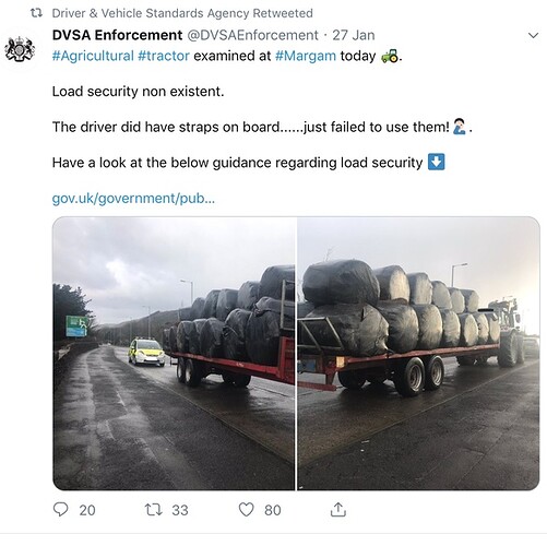

Looks like they got a wurzel
I wonder if the driver will get Bale :laughing: - taxi ordered !
Pennineman:
Cab operated rear marauder ( iirc that’s what they’re called ? ) and away !
Pennineman:
I heard he baled on foot.
You three are clutching at straws :slight_smile:
I’m sure that’s the last straw for that farmer!
