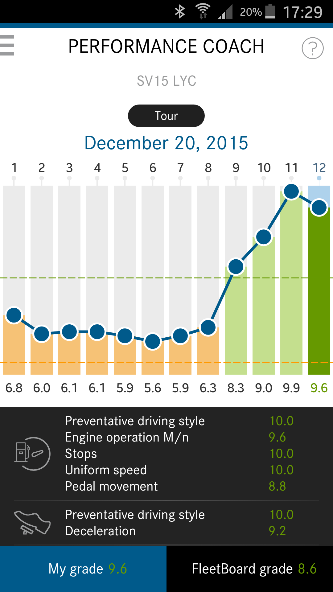

Done a run down to Normanton and back today. Didn’t run in economy mode as it limits the cruise control to 52.8mph. It’s tight for time so you need to push on a bit. Because of running out of eco mode, the Fleetboard eco support score dropped to 18% for speed and only 52% for gearshift. The rest of the sectors were in the high 90% area. Despite these lower scores, I somehow managed to get a 9.9 score on my way down and 9.6 on my way back on the fleetboard.[emoji53]
