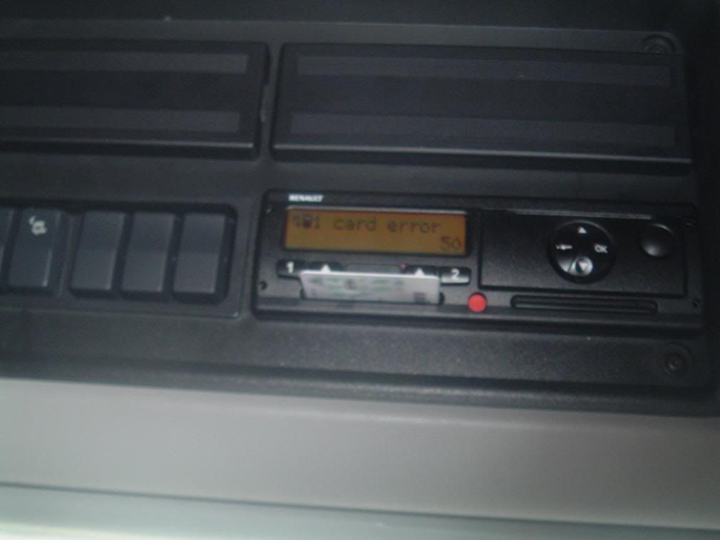

This how it went.
As soon as i put the card in it spat it out, so ran without the card. Tried it in another truck and same thing happened. So the card must be knackered., this is the 4th one in 12 months any one else had any problems like this?
The last time I used my card a couple of weeks ago, the tacho spat it out with error 50, I gave the card a gentle wipe with a clean cloth and it worked fine, could be coincidence I suppose but still worth trying.
