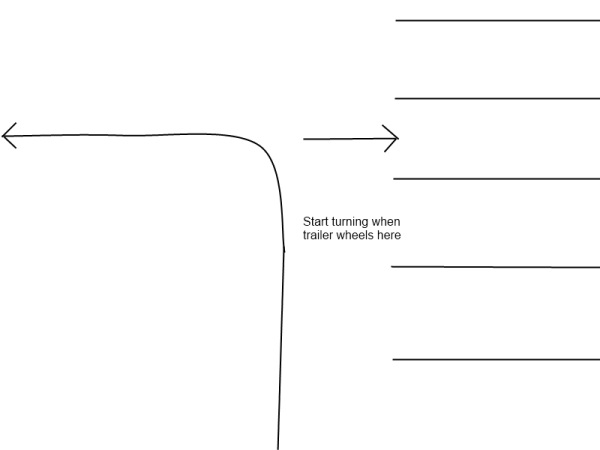

Sorry about the shoddy drawing but its easier than explaining. Like people say just set yourself up right and you’re more than halfway there.

I disagree with the advice you got about using the middle of the yard, that’s ok in a yard with plenty of room but they’re not all like that, far from it! Use all the space you have. Position yourself left of centre as close to whatever is on your left hand as you feel ok with. I’d suggest about 6 feet? Drive parallel to the bays until the rear of the trailer passes the bay you want then steer slightly to the left to create an angle for reversing. You should now be in a decent position to start your reverse. It will take a little practice before you get the idea about the best position for whatever yard you go to. It seems contrary to common sense to be over to the left but it will give you a nice gentle arc into the bay and minimise the chances of striking adjacent trailers. If in doubt Get Out And Look. GOAL! I do.

If you’re going onto a bay, between other trucks (as in most RDCs) - run along the front of the trucks/bays, close but not too close, after the cab passes the bay you want, keep going forward but swing to the left, until the trailer is past the bay, you should be on a 45 degree or less angle by now (the less the better), then bring the cab round to the right so you can see down the side. Looking back you should see your trailer is nicely lined up for the bay.
Stop, get out, open trailer doors - whilst taking a look at your bay, make sure it clear etc and how you are lined up etc
Engage R, slip it back in slowly.
