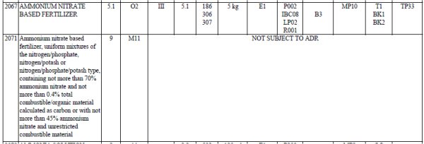

Does in not come in scope if more than 8 tonnes is carried?
bowserman:
No mate, Wherever did somebody dream up that it might?
Not subject to ADR means… not subject to ADR, so the amount is completely irrelevant, because it’s not subject to ADR.
As you can see, UN 2071 is not subject to ADR.
However, as you can also see, there are things written in the columns about UN 2067, so what I’ve written about the two different UN numbers is based on what ADR says about them for transport.
It’s possible that there’s an 8t limit for storage Regs, or for some other reason, but I keep myself to transport Regs. :smiley:
It’s 2067 we carry in bulk bags and you cannot load without ADR at Growhow, so this must be their particular rules for subcontractors.

Hi bowserman,
It’s not just Growhow’s site rules mate, it’s ADR Regs that say you need an ADR licence and that ADR applies in full if you’re carrying more than 1,000kg of UN 2067 in packages.
BTW, bulk bags are IBCs and IBCs are packages. :smiley:
