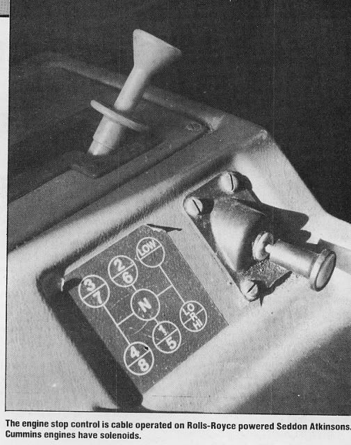

I had a Sed Atki Strato at John Dee not long after I past my test. It had a Twin Splitter in it. Best gearbox ever (once I got used to it!!)
I reckon the worst gearbox was them bloody Spicers in the T45 / Roadtrain
Got to agree with you Wheel-nut about the Spicer in the Roadtrain, had this one for a bit but couldnt take to it, she went well enough but just seemed to be a lot of hard work. Best gearbox ever the twin-splitter, had my Strato for 7 years on A.P. only used the clutch for pulling away & stopping, once you had the hang of it clutchless shifts like a knife thru butter, bloody good worker that old wagon!
Here are a couple to play a tune on.
A nice box in the Sed Ak, I preferred the gate that way around. Handiest gear was the one not marked ie crawler in high range! You could go from 5th across to “low” in high range and it would pull up a lot of banks without going into low range, when you needed to change back up you put the button into low range and whipped it back into 4th (low 4th was higher than crawler high) which gave you a quick change from there up into 5th in highrange. I also used crawler high when pulling away empty, it was smoother than using 3rd to 4th etc.
Pete.
